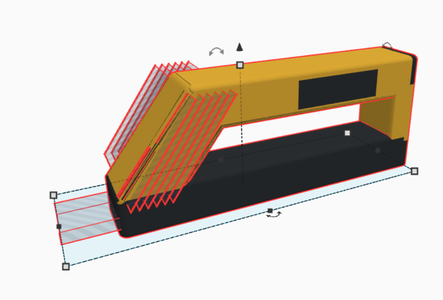

Step 2: Making the Base
I wanted to make a base that had an easy to handle and blunt grip. To do so, I rounded the edges of a box shape using the "Radius" slider and duplicated it into the shape of the handle I had chosen. To get the angle, I turned the selected box 45 degrees vertically. Afterwards, I placed a box to cut out where I wanted the tape measure to go as well as colored the base a mix between yellow and black and added some cool diagonal line patterns for detail. Notice I didn't color a black rectangular area at the top of the design. This will be where the bubble levels will go, and you'll learn how to make those later up in the tutorial.

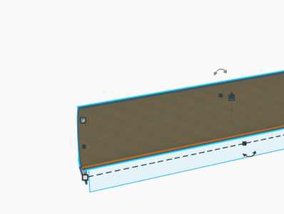

Step 3: Etching the Ruler In
I decided for my tool that I didn't want to waste all the space at the top by adding nothing but also didn't want to add a protrusion of some sorts (like a screwdriver head). Hence, I decided to build in a ruler you can use for simple tasks where you don't need to extend the tape measure, which we'll make later. All I did to make it was start with a simple rectangle, duplicating it and moving it, changing the length to be longer or shorter where needed. Then, I simply added the numbers 0-12 to mimic a real-life ruler. I aligned all of the rectangles and numbers with the top of the base and made sure they went down about 1mm so they could still be seen. Finally, I grouped the base with the stencil to get the final result.

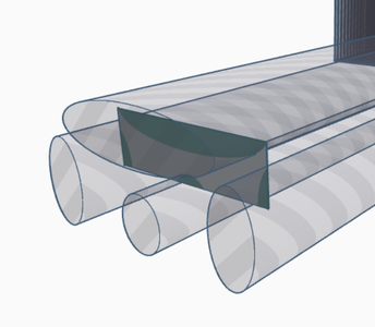

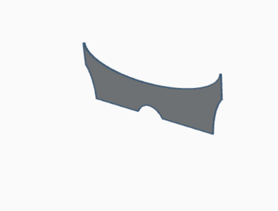

Step 4: Making the Hook
To make the hook of the tape measure, I simply took a rectangle, added a few cylinders to make the cuts, and grouped it. The top cylinder was used to make the hook align with the tape itself and the bottom middle cylinder is used to hook on nails or screws where necessary.
Step 5: Making the Tape
To make the tape, I took the top cylinder I used to cut out the shape of the hook and duplicated it. I then duplicated that cylinder and nudged it up about 0.1mm, turned the duplicated one into a hole and grouped the two. I then duplicated the ruler template from the base and grouped it into the tape to mimic the measurement part. Finally, I grouped the hook and the tape and inserted the combination into the slot in the base I had made earlier for it.

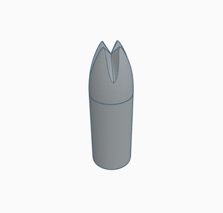

Step 10: Making a Simple Screwdriver Head
To make an example screwdriver head, I placed a cylinder with a tangent ogive shape on top as the base. To cut out the screw portion, I used a wavy-topped cylinder turned upside-down, turned it into a hole, and grouped the three shapes together.
Step 11: Adding Screwdriver Heads and Filling the Storage Compartments
For this step, I just added a screwdriver head into the shank, a few in the compartments, and made some nails using cylinders and cones to fill the last compartment.
