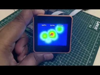

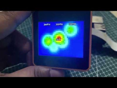

Step 4: The Thermal Camera Tool
yo, check this out! When you tap into the thermal camera mode on your All-In-One Pocket Tool with the M5Stack Core2, you get a live thermal video from the AMG8833 sensor, painting an 8x8 heatmap that shows hot and cold spots in real-time, plus the exact temperature of whatever you’re aiming at. It’s like having a superpower for spotting heat! In industrial settings, this is a game-changer—think factories where you can point it at machinery to catch overheating motors, dodgy electrical connections, or sneaky insulation leaks before they cost big bucks. For electronics geeks, it’s perfect for scanning Raspberry Pi motherboards or circuit boards to see which chips are running too hot, helping you tweak cooling setups. At home, it’s just as clutch: use it to find heat leaks in walls, check if your HVAC is slacking, or even spot critters hiding in the dark. Whether you’re troubleshooting heavy-duty equipment or just making sure your house is energy-efficient, this pocket-sized thermal camera’s got your back for work and everyday life!

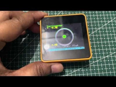

Step 5: Level Bubble
Now next hit the Reset button (BtnA, bottom-left) on your M5Stack Core2 to jump back to the main menu, then tap the “Bubble Level” button (orange, x:170, y:100). You’ll see a digital bubble leveler, like those liquid bubble tools, but better—showing a teal bubble moving in a cyan rectangle, with real-time roll and pitch angles in degrees (e.g., “Roll: 2.3°”, “Pitch: -1.5°”) and a “Flat” or “Tilted” status. It’s super accurate for getting things perfectly level or at specific angles. Use it for: mounting picture frames or paintings on walls at exact 90° angles, aligning shelves, setting up machinery in engineering projects, leveling furniture, or ensuring precise angles in DIY builds like decks or ramps. It’s your go-to for nailing perfect alignments at home or on the job!

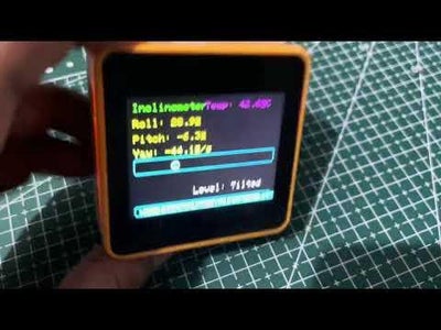

Step 6: Flat Surface and Inclinometer Compass
Hit the Reset button again then tap the “Inclinometer” You’ll see a circular dot smack in the middle of the display, reacting to angles and directions—if the surface is flat and all inclinations are at 0 degrees, it shows no tilting, the circle stays green, and the X and Z angle data reads 0 degrees. The circle moves in real-time toward the direction of any tilt if the surface is inclined at an angle, giving you instant feedback. Use it for: In everyday life, leveling your TV mount, aligning a pool table, or checking if your floor’s even during home renos; for professional engineers, it’s clutch in surveying construction sites for precise beam angles, calibrating machinery setups, designing ramps with exact slopes, or ensuring structural integrity in prototypes—making sure everything’s spot-on without guesswork!

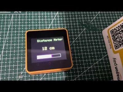

Step 7: Ruler Scale Distance Measurement
From the main menu on your M5Stack Core2, tap the “Distance” button (cyan, x:10, y:150) to jump into the Scale mode. The LCD now shows the distance measured by the VL53L0X ToF LIDAR sensor in real-time. Wave your hand or a pen in front of the sensor, and watch the display update instantly with the distance in centimeters (e.g., “Distance: 45.2 cm”). It’s like a digital ruler! Use it to measure walls, furniture, or room dimensions for home projects, just like you would with a tape measure. It’s perfect for DIY renovations, checking door clearances, or mapping out spaces with pinpoint accuracy—no tape required!
