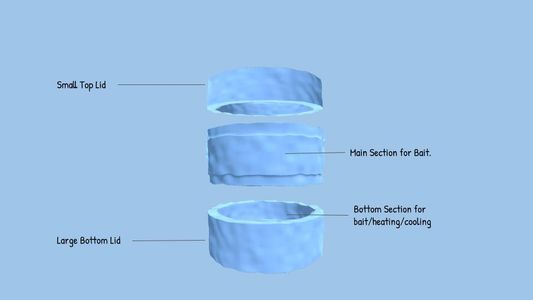

Step 2: Modeling a Basic Puck
For this simple project, you can use Fusion 360 but I preferred Tinker CAD cause we had to iterate a couple of times and I wanted more rapid prototyping. Its also more visual for explaining to a friend as I am modeling. Its also super easy to make a bait puck in Tinker CAD. (A Really good video I recommend for threads is thisone)
  • In a new Tinker CAD project, just make a simple cylinder, combine it with a smaller internal cylinder that is set to "hole" to make the base. A lid would simply be a smaller cylinder that goes on top. Resize these based on your agreed upon measurements from the previous section.
  • To add threads, select "ISO Metric Thread" from the "Shape Generators" and you can use these to add threads to your puck. I would recommend resizing the threads and adding a cylinder in the middle to make the minor diameter thicker. Male threads can be added to the lid by simply resizing the thread to your liking and combining it to the top. Female threads can be made by copying the male threads, setting them to hole and combining them with the base.
  • From that basic design, you can then tweak it to your liking based on your measurements and needed design tweaks. Additionally, a program like fusion 360 might be better for making better threads than the ones Tinker CAD makes which are better for rapid testing but not longevity.

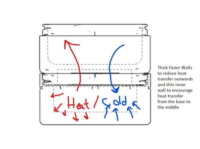

For our design, we went with a 3'' puck with 3 different parts: A top lid, middle section to hold bait, bottom section to hold hot hands heating packs to keep the bait warm. We also made it a lot smoother and printed it off to see what it would look and feel like.
We also wanted to make sure that the walls were thick and hollow to provide insulation using air so set infill to 10% and made it using tri-hexagons or tetrahedrons (i.e. any structure that will trap air in "pockets" as it prints)

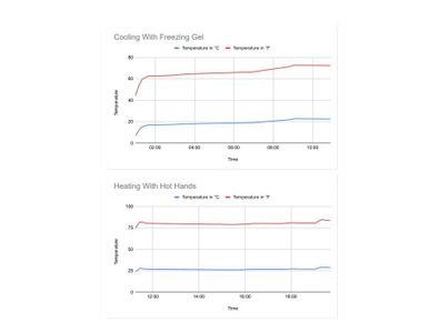

Step 4: Temperature Testing (Optional)
If needed, you can also run temperature testing on the puck. For this, we simply inserted a thermometer at the top of the puck and monitored the change in temperature over time. You could put the puck in a chilled container and see how well the insulation keeps it's temperature steady.
For my friend's design, he wanted the bottom to hold a hot hands heating pack (or cooling gel) and it was able to maintain a steady temp for at least 6 hours on both which is pretty good for a fishing trip.
