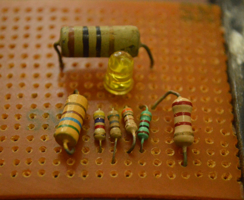

Step 5: Resistor Calculator for LED's
IMAGES:
- Various resistors and a LED.
- LED Resistance Calculator App Logo.
So the most common question asked about LED's is the appropriate resistor to use along with. The reason a resistor is used along with LED's is to protect them from excess current which can burn and damage the LED. But choosing the right LED isn't that simple. Why? Well if you choose a very high resistance, the LED will not emit its maximum light. And if you a low resistance there are chances of the LED getting Damaged.
So a simple formula was invented:
Resistance = (Source Voltage - LED Voltage) / (LED Current / 1000).
*Keep in mind, the LED Current is in milliamps(mA).
Inorder to make this calculation easier you can use this free Android App LED Resistance Calculator. It is an app designed especially for this Instructable. Other features and more electronics related functions and calculators will be added to this app. The app was developed by BluBot Technologies . You can check out his Instructables and contact him through his Orangeboard @Nathan Neal Dmello .He also undertakes various other projects in developing Apps, Websites, Computer Programs, etc. You can contact him through his website.

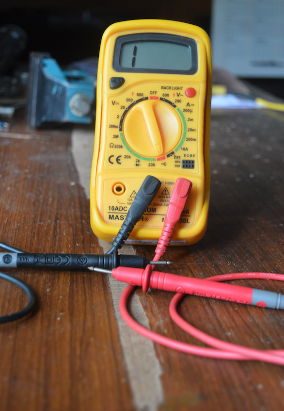

Testing
A classic quick tester for colour,brightness & polarity is just a 3V lithium coin cell(e.g. CR2032). Only touch lower voltage LEDs to this briefly of course, or they may overheat !
Some LED's can be tested inorder to check whether it is working properly using a multimeter & by following the steps:
- Set the dial of the multimeter to the 'Continiuity' function.
- Now connect the Anode(+) of the LED to the RED/Positive/(+) probe of the multimeter & connect the Cathode(-) of the LED to the BLACK/Negative/(-) probe of the multimeter.
- If the LED is working the Multimeter will start to make a 'Beep' sound. And a value will display on the screen of the multimeter. In addition to this the LED should light up.
*Testing an LED using the continuity function of a multimeter usually won't work because most multimeters apply only a low voltage, less than 1V, for the resistance and continuity tests. If it does, the multimeter won't make a continuous beep; it may make one short beep. Many multimeters have a diode test function, indicated by a diode symbol, which applies up to 2V across the diode. This will reliably tell you the polarity of many LEDs but not necessarily blue and white LEDs with high forward voltages.
