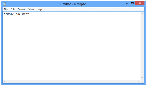

Step 1: Open Any Text Editor.
Firstly, you want to get a text editor for writing the html codes, For example :- Windows Notepad, TextEdit etc... You can use Any text editor of your choice for this purpose.

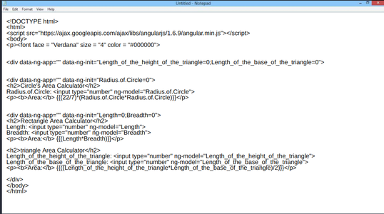

Step 2: Entering the Code
So, here comes the coding part. So, basically we are going to make an All in one Area calculator, which is capable of computing the area of various shapes such rectangle,triangle, circle etc. So On your text editing App enter the following codes :-
<pre><!DOCTYPE html>
<html>
<script src="https://ajax.googleapis.com/ajax/libs/angularjs/1.6.9/angular.min.js"></script>
<body>
<p><font face = "Verdana" size = "4" color = "#000000">
<div data-ng-app="" data-ng-init="Length_of_the_height_of_the_triangle=0;Length_of_the_base_of_the_triangle=0">
<div data-ng-app="" data-ng-init="Radius.of.Circle=0">
<h2>Circle's Area Calculator</h2>
Radius.of.Circle: <input type="number" ng-model="Radius.of.Circle">
<p><b>Area:</b> {{(22/7)*(Radius.of.Circle*Radius.of.Circle)}}</p>
<div data-ng-app="" data-ng-init="Length=0;Breadth=0">
<h2>Rectangle Area Calculator</h2>
Length: <input type="number" ng-model="Length">
Breadth: <input type="number" ng-model="Breadth">
<p><b>Area:</b> {{(Length*Breadth)}}</p>
<h2>triangle Area Calculator</h2>
Length_of_the_height_of_the_triangle: <input type="number" ng-model="Length_of_the_height_of_the_triangle">
Length_of_the_base_of_the_triangle: <input type="number" ng-model="Length_of_the_base_of_the_triangle">
<p><b>Area:</b> {{((Length_of_the_height_of_the_triangle*Length_of_the_base_of_the_triangle)/2)}}</p>
</div>
</body>
</html>
Just copy and paste the whole code in to your text editor.

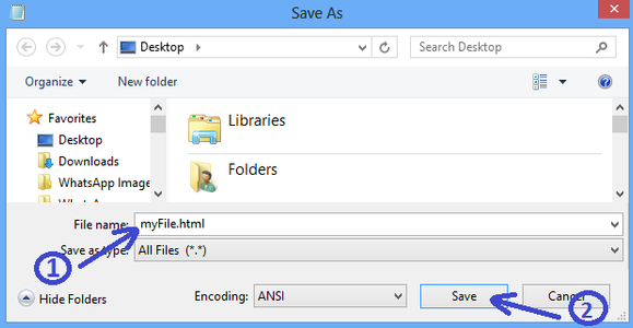

Step 3: Saving the Code (MOST IMPORTANT STEP)
So, after you enter the code make sure to save the file with the file name ending with " .html " . This is the most major step in this tutorial.

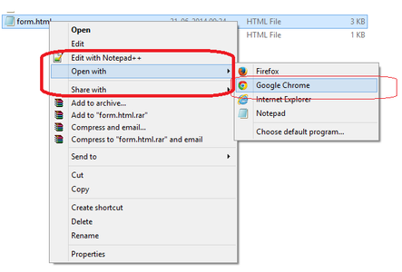

Step 4: Opening the Html
And after the saving the file. Locate to the saved html file on the Files. Then right click on the saved file. Then click the "open with" option. Select any app to open your html calculator, In my case i am choosing chrome browser to open my html file.
