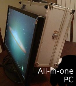

An all-in-one pc built inside a briefcase and mounted to a monitor using the Vesa mounting holes. The original plan was to build a laptop into the case but wanted more power and a larger monitor. When doing research online, few people have built such a computer and the term luggable PC was sometimes used.

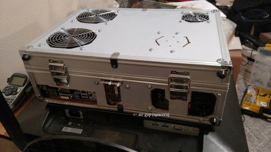

Step 3: General Layout and Placement
Before making any cuts, the general placement of the components need to be determined. Using AutoCAD a drew hole locations for the fans and hard drive. After determining where everything was to be located, holes were drilled for mounting the case to my monitor.
Aluminum bars were mounted to the case to add additional strength to case and provide better airflow behind the motherboard. Using the #6-32 tap, threaded holes were added to mount the motherboard standoffs. Much care was taken to make sure all holes lined up to the motherboard.

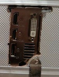

Step 4: Cutting Holes
Holes were marked for Power Supply, Fans, and motherboard I/O Ports, and PC slots.Then cut using the Dremel with 565 attachment. Additional holes added behind the hard drive and motherboard. Research indicated that negative pressure is better at cooling with an active cooling GPU unit. So more fans blowing out than blowing in. This will also draw air in through the extra holes and reduce dead air pockets.
After cutting holes, holes were sanded to remove loose debris and the inside and outside were cleaned to remove dust.
Most of the holes were marked using the actual component. I can not provide actual hole dimensions.

First the case was mounted to the monitor. spacers were placed between to allow airflow.
Components were mounted. this was very straightforward at this point except for the GPU. The GPU could not be installed while the motherboard was installed, not enough clearance above the PCI slot. A custom PCI was needed, see next step. The hard drive was mounted on spacers to provide airflow behind it.

Step 6: GPU Bracket.
To secure the GPU PCI bracket, a custom bracket was cut from aluminum with a coping saw. #6-13 threaded holes were cut to secure the card. bracket was attached with #6 screws and washers and locknuts.
