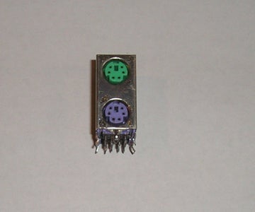

Jacks I use 6 per system I get them from old computer mother boards. The ones I used were dual plugs one on top of the other. So I can plug in up to 6 projects at once.

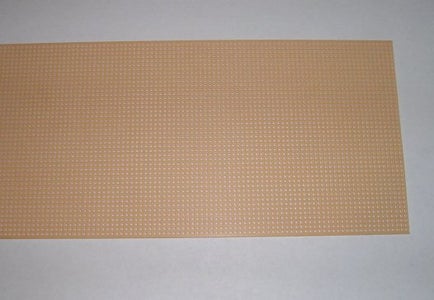

.1inch perforated board ( perfboard a pretty standard electronics item )

The sockets I found had 3 large tabs on the bottom, the middle one made the part difficult to mount so i broke it off. The other 2 large tabs did not fit into the perfboard http://en.wikipedia.org/wiki/Perfboard so I drilled out the holes until it did fit. Then I epoxied the sockets to the perf board. When the epoxy was hard I wired all the identical pins in parallel. To identify the needed pins ( not all pins are needed ) I inserted a keyboard plug and use a continuity tester ( or you can use an ohm meter ) on the colored wires. The common connection for each pin was brought to one place on the board where another cable was connected that in turn went to the power supply. When all the wiring was complete I mounted the perf board and sockets in a small plastic project box, a hole was cut in the box to access the sockets.

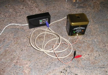

Connect it to a power supply, Connect one or more things to it. Turn it on. See photo.
