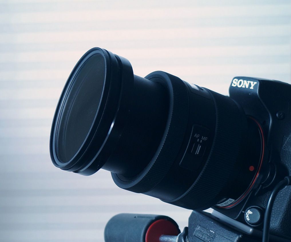

Step 2: Upcycle the 3D Glasses
Dismantle the 3D glasses to get the polarizing filters out. You don't care about the frames, just the thin plastic eyepiece. Be careful not to wrinkle them. If you want, you could just cut one of them out using a razor.
Eventually, you'll want two small squares of material, but it's very important to keep the orientation consistent. The polarized material is like a microscopic wood grain. It's not as important to know which way the grain runs, but it is critical that both pieces have the lines running the same direction. I did this by cutting a rectangle out of the material, then cutting that rectangle in half to get 2x squares.
NOTE: it is more important to get the cut that divides the piece in half at an exact right angle and then have these two edge touching later. Apparently, even a 1 degree misalignment of the polarization patterns will cause a blue hue. See comments from Dave.

Step 4: Figure Out the Correct Orientation for the Polarizing Filters.
There are 4 combinations to try. What you want is to find the DARKEST (most opaque) view when the filters are overlapped. Rotate the two squares 90 degrees to each other.
Flip one over so the back face is front.
Now rotate another 90 degrees.
The goal is to figure out what orientation has the darkest combination.
Ideally, you want the cut that separated the two halves to be touching the next step.
Step 5: Tape Filters Onto Camera
Once you've figured out which orientation is best, just tape one square over the camera and the other over the camera flash in this same orientation.
You should have the edges from the cut-in-half step touching and flush. This will help align the polarization "grain".
