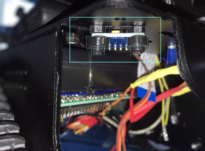

Most useful form of assembly:
I find the most useful form of assembly to be zip ties. With zip ties, you can attach anything to your robot chassis. I bought 2mm zip ties, so they could fit through any hole in my chassis.
If there is a good place to put a few screws however, in the case of my IMU sensor (in the images above), then screws should be inserted instead.
I also use 3D printed washers (seen in the above images) for spacing and to keep the chassis paint from being scratched.
