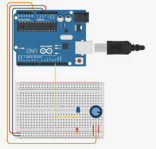

Step 2: Wiring the Arduino
1) Connect the 5v pin to the positive lead on the breadboard and the ground pin to the negative lead
2) Place the potentiometer into the breadboard
3) The center pin of the potentiometer should be connected to any of the analog in pins (A 0-5), the left pin needs to be connected to negative and the right pin needs to be connected to positive
4) Place one of your LED's in the breadboard, wire the positive to pin 7 and place a resistor to ground

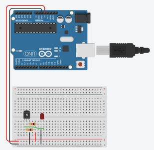

Step 3: Wiring the NOT Gate
Wiring the PNP transistor
1) Place the PNP resistor in the bread board
2) Connect the Emitter pin to ground (The pinout from left to right, looking at the flat side is, Emitter Base Collector)
3) Connect the Collector to positive using a 100 ohm resistor
4) Connect the Collector to the LED positive lead

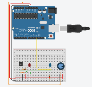

Step 4: Combing the NOT Gate With the Flashing LED
1) Connect the arduino 7 pin to the base pin of the LED
