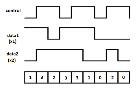

There are mainly 3 different ways for serial communication between arduino's, uart, i2c and spi. I made another one, just for fun.
It uses three wire's, two for data and one for control.
The state of the second dataline is multiplied by two, so the sum of the two datalines is a number from 0-3.
There are three sets in one cycle, the first is when de controlline is low, the second is when the controlline is high, and the third is when at least one the state changes while the controlline is high(see the example above),
the first two is for generating numbers from 0 to 9, while the third is for positioning: hunderds, tens and units, so that gives an output from 0-999 in three cycles(794 in the example).
To speed up, the hunderds and tens will be passed when they don't change.
The speed is controlled by the sender, the reciever waits for the units to recief and then calculate the sum.

Wire the boards as shown in image above, and connect the reciever to the pc, open the serial monitor (set baud rate at 9600), reset* the sender and look what happens, the numbers counts from 0 to 999 and start again from 0.
