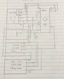

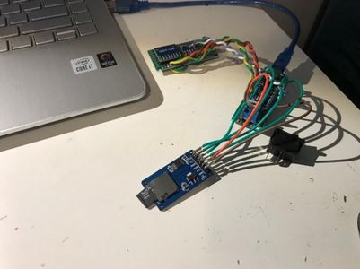

Step 4: Designing the Datalogger
This must record data from two sensors; an accelerometer which measures acceleration in three axes and an altimeter. It must:
1.     Interface with these sensors over a communications protocol (I2C Protocol).
2.     Store the data on an SD card, which uses a different protocol (SPI Protocol)
3.     Have on-board power management to ensure individual boards are each receiving the correct voltage.
The Arduino nano circuit board was selected as it met these requirements (including plentiful coding support documentation) and low price.
The sensors
1.     A pressure altimeter was selected (BMP180), with a refresh rate of 30Hz and accuracy +- 0.5m.
2.     An MPU6050 3-Axis Accelerometer was selected, due to low cost, reasonable accuracy (+-2G). This also came with an onboard gyroscope (to detect the rocket’s attitude), allowing further performance analysis.
The Battery
Requirements:
1.  lightweight,
2.  compact,
3.  impact resistant.
4.  Must supply a minimum of 7v to the Arduino’s voltage in pin to power it.
A 2 cell, Small LiPo battery (typically used for remote-controlled cars) was selected and delivered a voltage of 7.4v in addition to meeting the other requirements
The Program
This was then tested for component function and interfaced with a program, written in Python which did the following:
1.  Activated and tested the sensors
2.  Indicated a successful test by lighting a green LED
3.  Waited 40 seconds (to enable the launch technician to achieve a safe distance from the launch site)
4.  Read a baseline temperature and pressure
5.  Recorded acceleration, pressure and temperature and attitude every 10th of a second
6.  Saved data to the SD card
Altitude is calculated from this information, which was done post-recovery, this saved processing power in-flight, enabling a high frequency of data collection.

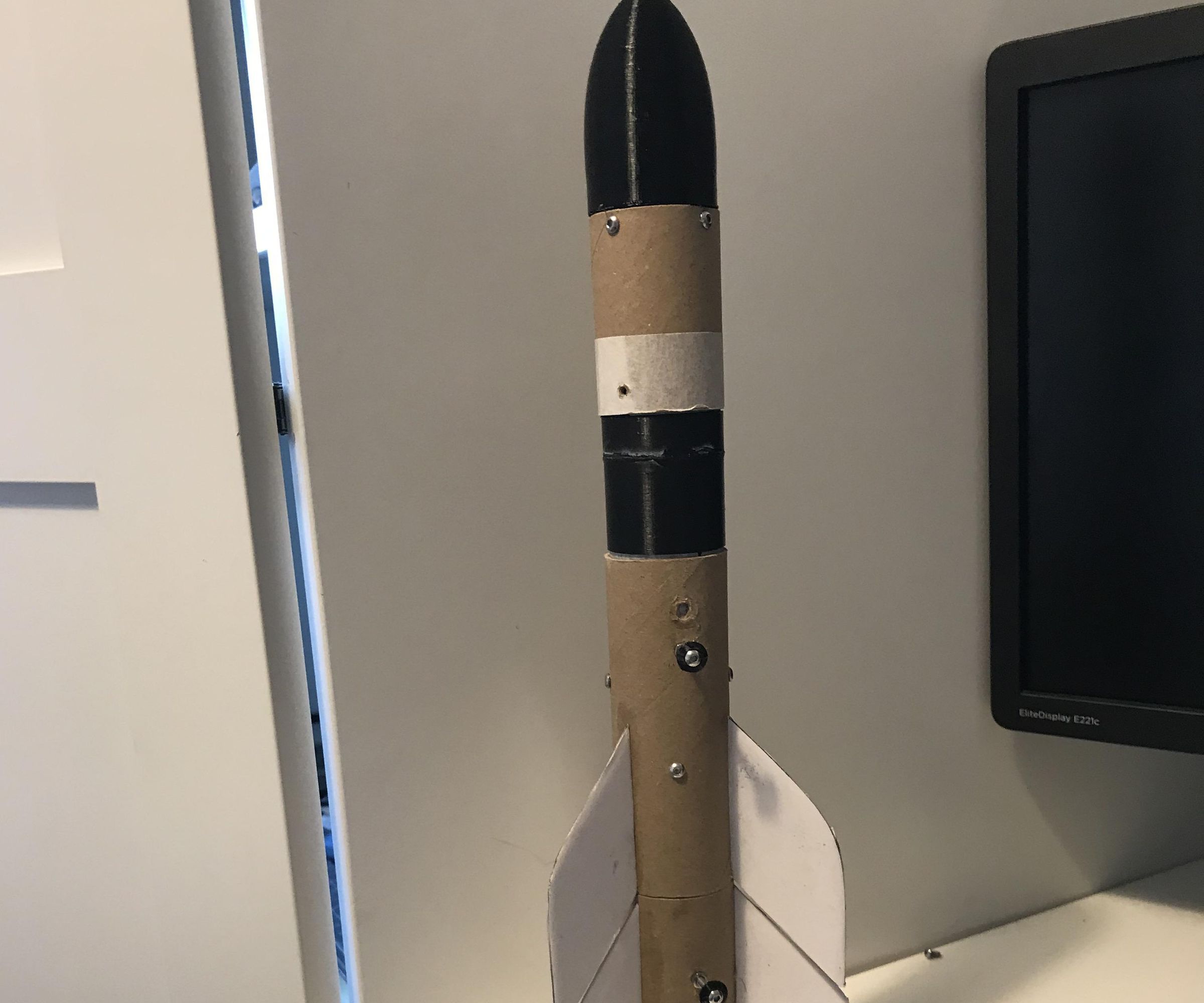

Step 5: Designing the Version 1 Rocket
With all the prerequisite controls and hardware laid out, the design of the V1 rocket could begin. This rocket was deliberately big and unrefined so I could practise construction techniques as I was still unfamiliar with the use of 3D printers and CAD. Firstly, our limitations had to be understood, starting with;
The Engine
Motors come as a pre-built unit, with a set impulse and thrust. The most powerful, easily accessible engine in the UK is an Estes D-12 motor. A D-12 motor has an impulse of 24Ns and an average thrust of 12N, meaning it produces thrust for roughly 2 seconds. This motor has a recommended take-off weight of around 300 grams. This is the main reason for its selection, as it has a wide margin, so a heavy, unoptimized rocket is supported.

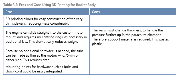

Body Tube
The body tube was made from a cardboard tube as this was readily available, easy to integrate with 3D printed nose cone and fin sections, was the correct width for the data logger and crucial to one of the success criteria was also inexpensive and lightweight.

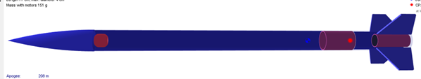

With these two limitations in mind, a preliminary design, with traditional construction was designed in OpenRocket - a free open source rocket simulation tool. Using the values for the chosen body tube, and generating some 3D printable component designs of fins and nose cones, a rough working model of the V1 rocket was generated. The tool simulates the max altitude and acceleration using parameters such as tube shape, engine specification, nosecone profile and fin shape, producing the design shown in the photograph. Having verified this design would work, I hopped into fusion 360 to draw up some designs for the nosecone, adapters and fin sections which would require 3d printing.

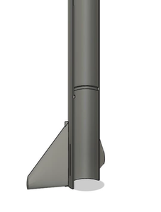

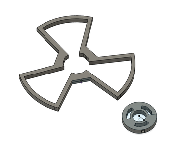

Step 6: Designing the CAD Model
The CAD model was developed to the same dimensions produced from the Open Rocket simulation. To save mass, the entire lower stage was designed as one component rather than the numerous traditionally discrete fins, couplers and body tubes presentonother designs. I also designed the fins to extend from the outer skin all the way through to the motor mount, enabling the fins to provide the bulk of the structure and for the core of the component to be hollow. this too is shown in the photographs in a cutaway style. Fusion 360's built in slicer was used to generate the gcode for the 3d printer.

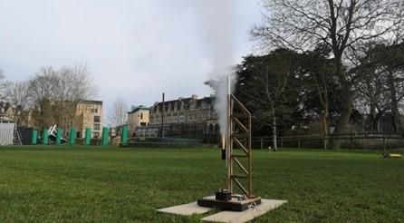

Step 7: Flight Tests of the V1

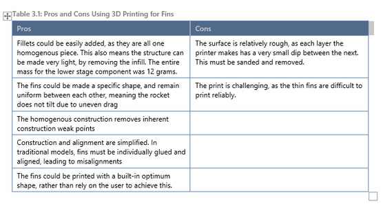

Some advantages of 3d printing as a construction method were found to be;
With similar dimensions to existing models, the manufacturing method was shown to withstand crashes better and remove any possibility of assembly error. Provide prototyping rapidly and produced fins thinner than possible with balsa equivalents. The flexibility of this construction method also proved useful, as the nosecone could be made to any shape or width, and have a built-in coupler. The datalogger readouts are shown below. These will later be used to compare between designs.

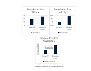

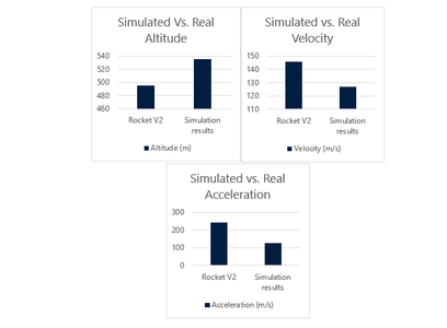

Step 8: Comparison of Flight Data Against Simulated Results
As can be seen from the graphs above, the data was very similar to the predicted results. I am therefore happy that the 3d printer was able to produce parts very similar to those simulated by open rocket, at least in mass terms, as the rocket still accelerated as predicted. In terms of the quality of parts, the surface and poor chamfer quality meant the rocket was far less aerodynamically optimised than simulated, and the final altitude was lower. This meant more time needed to be put into the prints, as by reducing the layer height, increasing the time of the print, better surface finishes can be achieved.

 The fins required chamfering post-print. This was laborious and added inaccuracy.

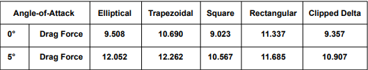

Step 10: Optimising the Fins
For maximum height gain, drag should be minimal. However, drag caused by the fin shape and location on the rocket body is necessary to lower the centre of pressure below the centre of mass. This is a critical idea within stability, as if these centres are not in the correct place, the rocket will be unstable. Ideally, this fin drag should only be caused when the rocket has an angle of attack greater than zero, meaning that when in flight with zero Angle of Attack (AoA), drag is minimal. The reason for this, is that ift the rocket has no AoA, it does not need stabilisation, and thus the fins should produced minimal drag. However, as soon as the rocket has AoA, it requires the restorative drag force from the fins to stabilise it.
Fin Shape
The pressure drag is derived from the length and thickness, bluntness of the tip and tail, and surface roughness. According to a report by Tim Van Milligan; by reducing the length of the fins, making them thinner, creating a symmetrical aerofoil plan and selecting tapering fins, the drag can be reduced hugely. (Milligan, 2017). The report detailed tests on several fin shapes with the same span and thickness, placed in a virtual wind tunnel with 100m/s of wind speed, with results shown in the attached photo.
As already established, low drag at 0 degrees AoA and the greatest difference between 0 and 5 degrees AoA gives the best design. While the elliptical fin best fulfilled these requirements, it proved too complicated to 3D print; as the support material meant an uneven finish. A clipped delta shape was therefore selected.

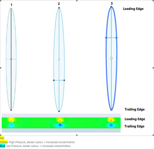

The fin's cross section also matters. To determine the best shape, a test was devised;
Fin Cross Section Test
Hypothesis: The rearward bulge and symmetrical shape will deliver the smallest high-pressure region ahead of the fin and low pressure behind, as the airflow will be divided more gradually.
Methodology: A drag analysis tool ‘Fusion CFD’ was used to test these 3 fin cross-sections. The fins had their points of maximum thickness in various places, as shown in the image above, showing the 2D model of the fin's cross section:
Three designs were tested:
1.     Symmetrical, central bulge
2.     Symmetrical, rear bulge
3.     Symmetrical, front bulge
Control Variables: The velocities of air, and pressures were set to the same as the apogee fin shape test. A frontal airspeed of 100m/s was applied to 3 fins: each with different cross-sections but the same span, thickness, and root chord.
Results: As shown in the photos, the results indicated that a foil with a central bulge produced the smallest low-pressure zone behind the fin, and the smallest high-pressure zone ahead of the fin. The bulges were placed 75% of the way along each fin.
1.     Symmetrical, central bulge: 3.83 Newtons drag force
2.     Symmetrical, rear bulge: 4.51 Newtons drag force
3.     Symmetrical, front bulge: 4.91 Newton drag force
Analysis: The best shape for the fins would be a symmetrical, centrally bulging Shape 1. This is because:
  It has the lowest drag force
  A smaller orange section ahead of the leading edge of the fin (high pressure) is shown on this cross-section meaning that it is causing less compression ahead of the fin, reducing opposition to movement
  A smaller blue section (low pressure) behind the trailing edge of the fin creates less vacuum, reducing the suction on the trailing edge of the fin and less distortion to the airflow
Conclusion: The hypothesis was disproved. While the fin did indeed produce the least high-pressure section on the leading edge, the very fast re-converging of the airflow at the trailing edge produced a very large low-pressure region, sucking the fin back, and removing the advantages of the long leading edge. Shape 1 will be used on Rocket V2.
Some other points of interest during fin design:
Interference drag between the body tube and model is also large, without a fillet; air flows in the harsh corner channel and becomes turbulent. Approximations have been made that a fillet of diameter of roughly 4% of the root chord of the fin provides the greatest reduction in fin-body drag without beginning to increase fin drag.
The final mass was reduced as much as possible, by making the fins as hollow as possible. A 15% infill was used.
The fins were made as thin as possible, to reduce their frontal area. This minimised the fin drag at 0 AoA.

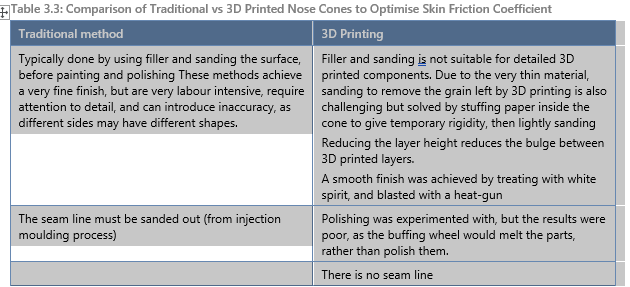

The greater the surface area that is exposed to the flow of air, the greater the skin friction. The purpose of this component is to contain the parachute and motor as compactly and lightweight as possible. By reducing the frontal cross-section, the drag coefficient for the entire rocket is dramatically reduced, as less air must be displaced. Therefore, To optimise this component, it must essentially be made as short and thin as possible. The component was thinned to a mere 25 mm diameter. This was only 1 mm more than the outer dimeter of the motor. It was therefore as thin as possible. The length was minimised, but could have been shorter. The reason for this preservation of length is to bring the centre of mass up the rocket. Because all of the weighty components are stored at the top of the body tube, the decision was made to lengthen it a bit. This brought the centre of mass up. This meant smaller fins were necessary to bring the centre of pressure down, as the rocket would still have the centres in the correct orientation if the centre of pressure was allowed to raise a bit and as a result, overall drag decreased. To reduce the mass of the rocket, the body tube, motor mount and fin section was now combined into one component, with the nosecone being the opening for the parachute, rather than the rocket breaking open in the centre, as on the previous design. The electronics for altitude measurement had been reduced in size and were now stored inside the nosecone. A picture illustrating the ejection of the parachute has been attached.
Step 12: Launch Lug
The previous model rocket had used a launch lug attached to the rocket, which could slide up and down the launch rail. This provided the rocket with stability while it was getting up to speed. Since the rocket was now so thin, adding a lunch lug proved to upset the balance so much the rocket tipped over during flight, as the frontal area was so asymmetric. Therefore, the lug was removed and replaced with a launch tube system. the rocket slid up the centre, as illustrated in the photo. This tube was also designed in fusion 360.
Step 13: Nosecone
The shape of the nosecone was arrived at through online research. It was understood that for subsonic flight, rounded ogive and paraboloid/elliptical shapes have the least drag, through examination of other performance models. To determine which should be used, Fusion CFD was again used, and the tended toward parabolic. This was then used in the final OpenRocket file, and the parameters of the shape adjusted. It was found that a longer nosecone lowered the drag coefficient. I assume this was because the air was divided more gradually. The length was increased until the mass started to increase enough to lower the predicted altitude. The final dimensions produced a 10cm long nosecone. The width of the part's walls were made a mere 0.4mm; only 1 layer thick on the 3D printer. This meant the entire component was a mere 8 grams.

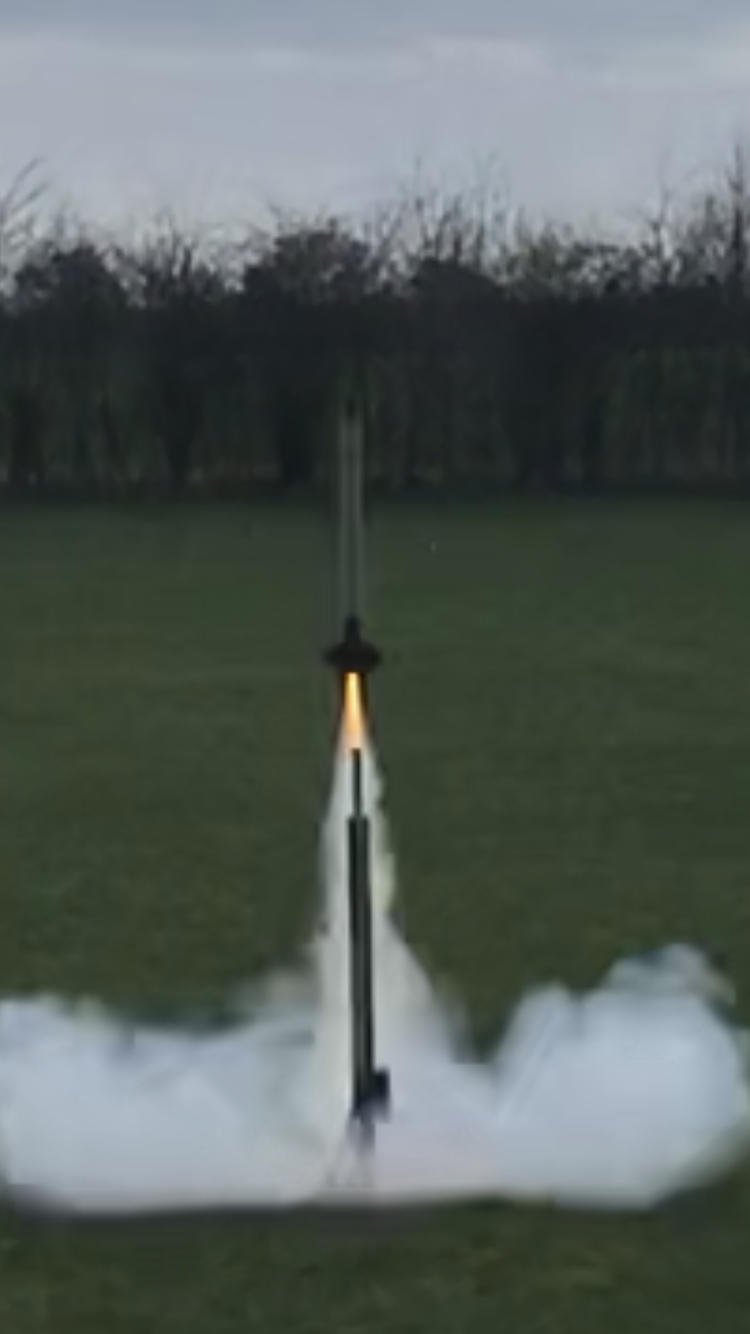

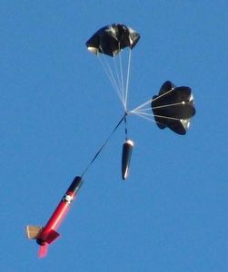

Step 14: Flight Tests
These results are very similar. It is believed that the poorer altitude performance is due to some remaining surface roughness on the nose that was not accurately simulated. The nosecone proved tricky to sand, as to make it light enough to compete with its commercially available injection moulded counterparts, the component was only 1 layer thick (0.4mm). This resulted in a flexible construction, but with a tendency to break along the layer lines. This caused difficulties in sanding. The superior maximum speed may be caused by a defect in the engine, leading to longer burn time, as all other factors were the same as the simulation.
Lessons Learnt:
The lightening of the overall design, improvements in aerodynamic efficiency and removal of any launch rail drag meant more energy was transferred to the Ep store.
The light airframe resulted in immensely fast acceleration. This would not be ideal for a long flight, as greater speeds mean greater drag, but with short-burn motors such as these, this is ideal.
The very small amount of plastic necessary to create this design meant it cost very little to produce, and was a very fast print; the rocket was constructed from start to finish in 6 hours, with only 30 minutes of times from the constructor in sanding and support material removal.
The need for a 1-layer thick nosecone to reduce mass, meant that in the sanding and sealing process, it broke frequently. This required sealing with superglue. The component did survive flight, but then broke upon the fast landing.

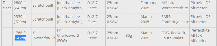

Step 15: Comparison Against Records
While the current altitude record are still roughly 40 metres greater than my own (UK Rocketry Altitude Records | UKRA - United Kingdom Rocketry Association) for the D12 class of motor, the mass of these competition rockets is considerably less. I believe the relatively high mass (25 grams) of my own homebuilt datalogger is making the rocket heavier than necessary. Indeed the pico alt LO3 used by these record holders weighs in at only 10 grams. Overall, therefore, I conclude from this investigation that 3d printing technology, when applied in a performance manner to model rocketry is more than capable of holding it's own, and provides numerous construction advantages.
