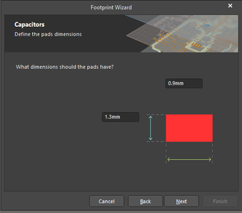

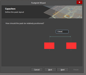

  • Go into the PCB library click on Tools→Footprint Wizard
  • A footprint wizard box will appear
  • Click on Next Select Capacitor or Resistor as per design requirement and units to Metric(mm)
  • Choose the Surface mount option To change the dimensions of the components look into the Datasheet. Here I have used C0805, R0805
  • Keep the rest of the things the same and click on Finish

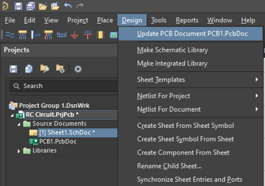

  • Now we are done with the schematic. Click on Design→Update PCB document. This will convert my schematic design to the PCB design

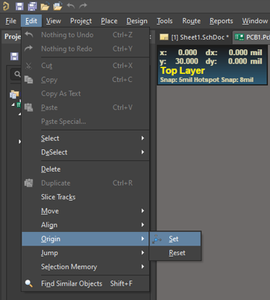

  • The first step in the PCB design is to change the size of the board and set the origin. Click on Edit→Origin→Set and click on the left bottom corner of the board to set it as an origin

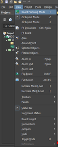

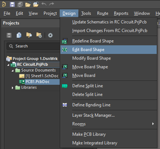

  • To change the size of the board click on View→Board Planning Mode. Now go to Design→Edit Board Shape. Change the shape as per components sizes

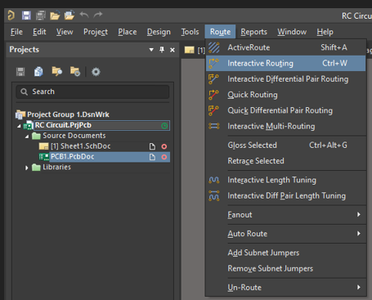

  • Now drag the components on the PCB board and arrange them. To add connection on the PCB board I will click on Route→Interactive Routing. This will allow me to add connections on the top layer of the PCB board
