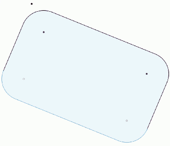

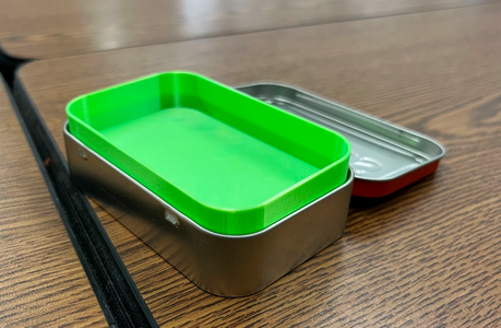

Step 1: Measure the Altoid Tins
Before we started designing, we needed a shell that would fit snugly inside the tin, so we could just slide in the 3D print once they are fabricated.
Using a caliper, we measured the inner dimensions and bottom height of the Altoids tin the best we could, using the depth rod on the end as well. Then we compared those to the numerous measurements for these tins published online, since Altoids Tins are used so widely in projects. The most accurate ones we found were here.

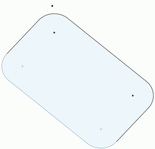

Step 2: Design Base Shell and Test Fit
After we got the dimensions, we designed a base for the designs that would fit inside those dimensions. We did a simple design with just a floor and walls. The shell has 1mm thick walls.
Then we printed out one just to see if it fits right, before moving onto designing the actual games. It would be a shame if the game didn't fit inside after we take the time to print it after all. Ours fit quite snugly through the opening with the lip, though once in it did have move to room around.

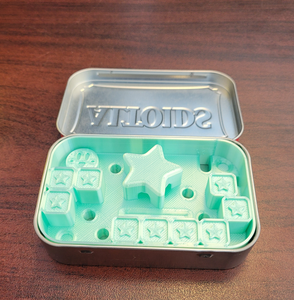

Step 4: Kirby Design
The Kirby design was the first design we attempted. It was intended it to be fairly easy, so the paths were pretty straightforward.
To start off, there were three props for this design, the Star, Kirby, and the Star Block. We made them as separate components to make the process simpler. For example, the Star Block has a very complicated sketch, so replicating the feature over and over again would be tedious. Instead it was better to have it as a separate component, which can be replicated and moved around easily.
This allowed us to make a guiding path out of the Star Blocks. We also added in the Star as a centerpiece and the Kirby as a decoration, before adding all the pitfall holes and the starting and ending indentations. The pitfall holes and starting and ending indentations were made with a sketch and extrusion directly on the base shell. We also made a sloped track in the middle to try to make navigation a bit more difficult.
We rearranged the props while I figure out the design, which is easy because they were separate components! It's best to use the align tool and joint planar tools to keep things in place or at certain locations. For example, the Star had a planar joint between it's bottom surface and the base shell floor.

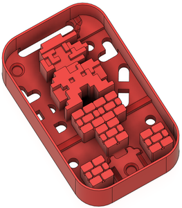

Step 5: Mario Design
For the Mario design we wanted a large centerpiece that would add a lot of visual interest, so I made the Mario sprite and the bricks from Mario as giant props. This design was intended to be much harder and we wanted to experiment more, so we added a lot of experimental slopes and irregularly shaped holes. Most of this was done using methods established previously in the Kirby Design. For some slopes we used chamfers or fillets.
Step 6: Initial Prints
With the initial prints, we could see if the designs printed successfully and also play test the designs. They all fit perfectly, which was good. Placing a bearing ball, we tried to navigate our way from start to end. What we found was that our slopes and chamfers were too steep, and paths too thin. We took this as a lesson and added tolerances to future designs to allow for easier traversal.

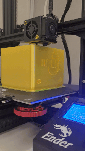

Step 14: Printing
The scale of the mystery block was much too large originally. The first model would take almost 3 days to print and use over 825 grams of filament. To reduce the print time while still maintaining the same style, we turned the question mark into an indentation rather than an extrusion, while also added a secret compartment to reduce print time as well. The original block also shrunk from 150 mm to 120 mm, this allowed us to cut down the print time by over 24 hours and the filament weight by 500 grams.
Printing this part of the project was done over several days, and turned out well in quality, about what was expected. It did take a long time because of the size of the print.
