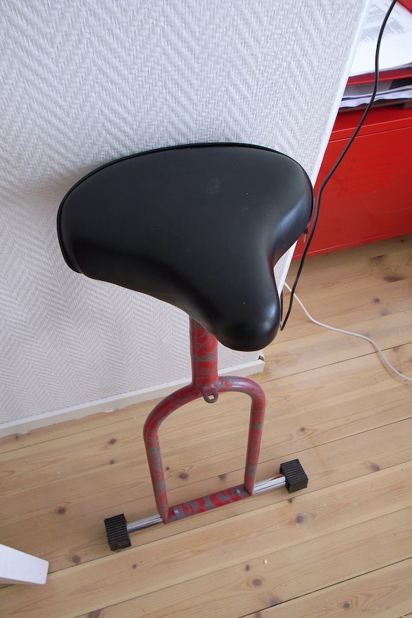

Now I'm going to make a stool out of an old excersice bicycle I found to match the desk.
