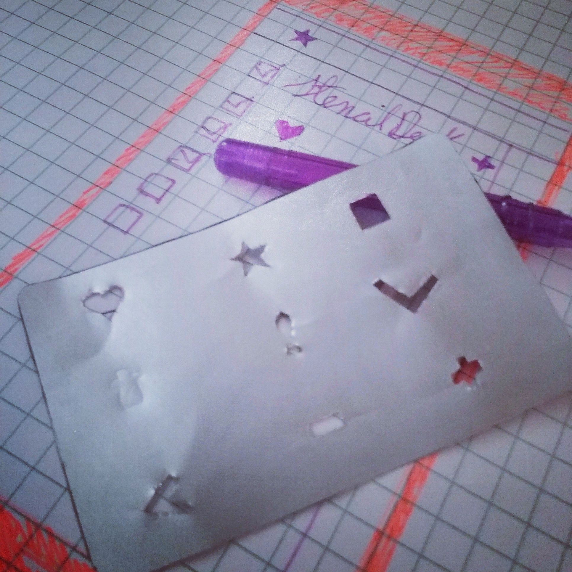

Step 1: Skin and Flatten the Soda Can
- (Xacto)
Score a circle around the circumference of the can's top. - Remove the top.
- Score another circle around the circumference of the can's base.
- Remove the base.
- (scissors)
Cut down the center of the can - (on a corner or pipe)
'Stretch' the aluminium sheet over the corner. (since the aluminium is malleable, it doesn't take much force)
Step 2: Cut Out a Card
I like the idea of having my stencils in a deck of cards for easy access so, I will be using the size of a credit card. Use any size you like.
- (pen)
Trace around the credit card's perimeter. - (knife)
Score around the credit card's perimeter. - Punch out (pry)
Step 3: Transfer Your Vector
- Using a marker outline your vector.
- (Xacto)
Score the outline of your vector as before when removing the card. - Punch out or pry up the vectored piece.
