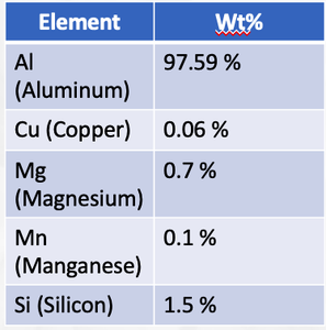

  13. Alloying Materials (refer to the image and table below)
  14. Tongs
  15. Tabletop Bandsaw
Step 1: Alloy Selection

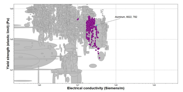

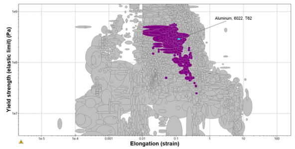

First, start by selecting an alloy. Use Granta to identify an alloy that offers an exceptional balance of characteristics, including the highest yield strength, percentage elongation, and electrical conductivity.
The chosen alloy is 6022-T62, which has a predicted yield strength of 300 MPa, an expected elongation of 5.1% EL, and an electrical conductivity of 43.3 S/m.
The alloying constituents are detailed in the table above.

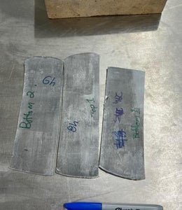

First, the sample was cut in to four parts using a tabletop band saw. The sample was then heated to 500 degrees Celsius in a furnace and subsequently placed into a pre-hot rolling furnace until it was deemed suitable for hot rolling. A long rod was required to push the sample into the rolling region. The rolling mill itself was heated to 200 degrees Celsius.
Each individual sample was then rolled until it reached a thickness of 2 to 3 mm. This process was repeated for all four samples. After the hot rolling was complete, samples were left to cool on bricks.

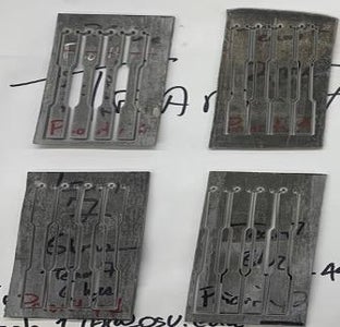

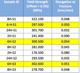

After the solution heat treatment and artificial aging, multiple tensile bars should be cut from each plate. The scraps generated from this process can be used to test hardness and conductivity. Tensile testing indicated that hardness and elongation peaked at the six-hour aging mark, suggesting that the T62 temper was achieved at this duration. The results from the 2-hour and 8-hour tests were promising; however, they were inconsistent. For replicating results effectively, it is essential to test tensile bars from multiple treatment times to confirm that the T62 temper has been achieved and to select the bar with the desired quality.
Step 6: Competition Results
The competition results indicated that the predicted electrical conductivity of the 6-hour 6023-T62 alloy sample closely matched the measured value of 43.34 S/m. However, the yield strength and elongation values were slightly lower than expected, measuring 291.4 MPa and 4.3% elongation, respectively. This performance placed us in 5th place in the competition.

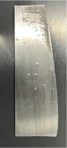

The casting was nearly flawless, with only minor surface cracks present.

In order to avoid the porosity issues we encountered while testing our tensile bars, it is crucial to ensure that the pouring process is slow and controlled. Pour the metal steadily and consistently to avoid introducing air during solidification. Additionally, heat the mold adequately using a blowtorch or furnace to prevent thermal shock, which can cause rapid solidification and increase porosity. A higher temperature and extended homogenization may yield better samples that fracture in a more predictable manner. Additionally, it may be important to try longer aging times, particularly with overaging.
