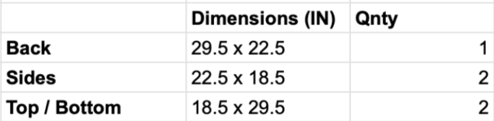

To make sure that everything lines up and creates a perfectly dimensioned box, I was very careful when cutting my material to length measuring twice so that I would only have to cut once. To start, I laid out a spreadsheet of each dimension of material that I would need for my box and marked them off as I finished cutting those lengths.

To create the walls of my enclosure, I used 1/4 inch MDF because using a little bit of elbow grease, you can get it to perfectly friction fit within the slots of the aluminum extrusion. Just like in the measurements of the Aluminum Extrusions, I used a spreadsheet to map out the size of each piece I needed. I used the length & width of the box minus 1/2 inch on each side to get it to perfectly fit within the frame.
Now, with all of my measurements in front of me, I carefully measured and cut out each of the pieces. With all of my perfectly sized pieces, I then removed one of the sides & slid the MDF into position before placing the extrusion side back into place to securely hold it still. For the windows, I used 1/8 inch acrylic which does move around a little bit within the extrusion, but I created 3d printed mounts to make sure that the movement was minimal.
