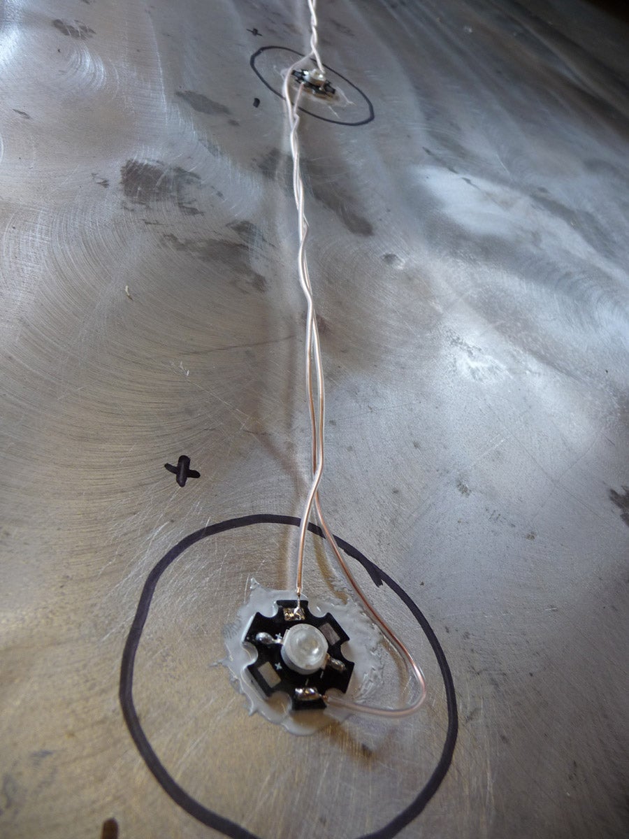

- Luxeon Stars are epoxied on and allowed to dry.
- Wires connect the LEDs in series, resistor is attached.

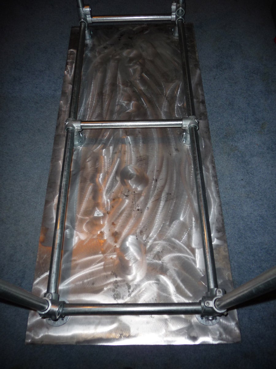

- Flange holes are marked, and drilled out.
- Bolts are inserted through, and lightly tightened onto the flanges. Plate is flipped over, and the carriage bolts are hit with a hammer to lock them in place. The nuts are then fully tightened with a crescent wrench.
- Legs are lightly attached to the flanges.
- Pipes are measured and cut with a mitre saw or hacksaw. Then assembled into frames and dropped over the legs.
- Tightening of Kee-Klamps.

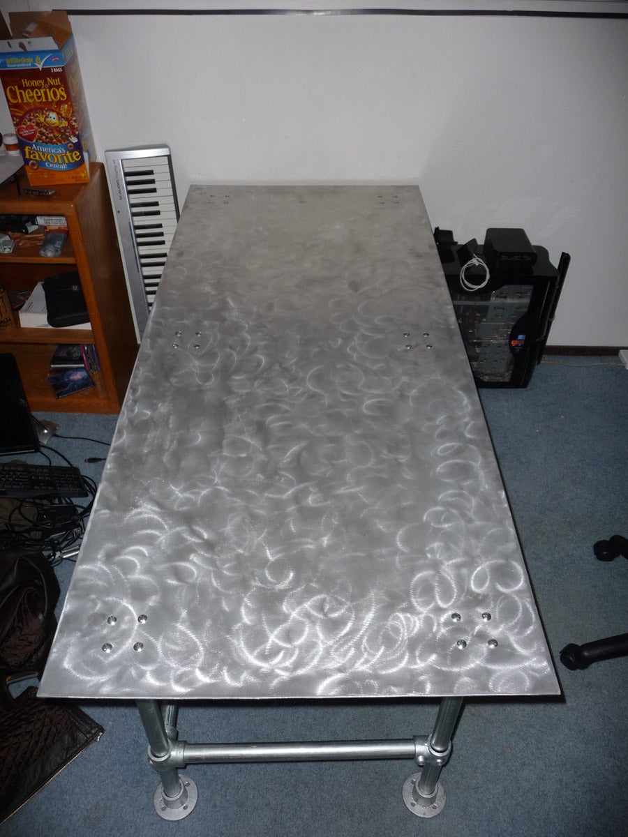

Step 4: Polishing
Cleaning
Use Acetone or another solvent (grease cleaner) to dissolve the sharpie marks and remove the cutting fluid. If your plates have any dirt, remove it with a broom. Give the plate a quick rinse with a towel and water.
Important Notes for Polishing
Friction polishing produces an extreme amount of heat, too much heat can
A) Heavily oxidize the aluminum (dull shine, it can always be polished away once it cools off).
B) Physically warp the plate into a curve.
Don't polish the whole plate in one go, work in 10-20 minute bursts distributed across the plate. Give it time to cool down.
Underside Light Pass
Pick a side to be the top surface. Whichever side has less deep scratches is best. This step is just to keep the plate from rubbing off on your carpet or dropping dust. Move the brush quickly along at an angle of about 30 degrees. If you work on the floor, It's easier on your back to rest your elbow on your knee and pivot.
Top-side Scratch Removal & Heavy Pass
For scratch-removal move slightly perpendicular along the cut (20-30 degrees rotated) at a brush angle of 70-80 degrees. Remove any and all dull spots on the plate. Side-cast light makes it easier to see dull spots. Move in a left -> right, up -> down pattern in strips across the plate. The pictures provide examples.
Swirls
Vigorously push the brush in tight circles while working at a 0 degree angle. The grinder will do most of the work, just keep it under control.

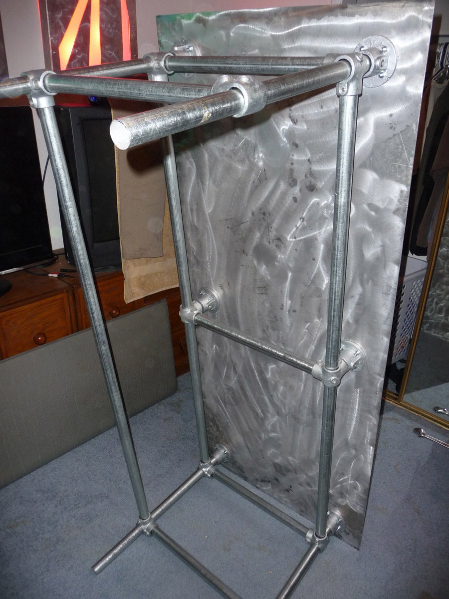

Step 5: Mounting Flanges
Marking and Drilling
Four inches from the corner of each plate, lay the flange center over your mark. Using a sharpie, mark in the holes. Drill through the sharpie marks. Start with a 1/4" bit, then expand to 9/16". If a hole is slightly off, attach the flange tightly with two bolts, then drill through the misaligned holes.
Carriage Bolts
These bolts have a round head with a square base directly underneath it. The threads should pass through, but the square base under the head should not. A 9/16" bit is perfect for a 1/4" diameter carriage bolt. Place your bolts through the holes, lay the flange over them, and lightly thread a nut onto each bolt. Flip over the plate. Place a cloth over the carriage bolt, and smash it with the hammer until it is flush. If the bolts are popping back up, they will become flush once we tighten them. The corners of the square base should cut into the plate, keeping the bolt from rotating.
Tighten the nuts with a crescent wrench.
Carriage Bolts

All of the LEDs are wired in series, into one LED and through the others.
A single 5W 3.3 Ohm resistor is used for 3x series Blue and 4x series Red, each color when running at 12 volts.
I use LEDCalc.com to calculate my resistor types. The names mean:
LED Mounting
Scrape with sandpaper, or polish with the wire-brush, wherever an LED will be bonded. It needs a clean connection to the aluminum for proper heat transfer, so rub the scrape with some acetone and a rag. Mix your Artic Alumina Ceramic Thermal Epoxy, about the size of a pea from each tube for three LEDs. Apply to the aluminum plate, press down the LED, and move it in a little circle until there is total coverage. Wait ~10 minutes for the epoxy to harden.
Step 7: LED Installation Part Two (Wiring)
Wires
Measure out your wire from the negative of one LED to the positive of its neighbor. After cutting, trim off 1/8" of plastic sheathing from the tip of each wire.
Tinning
*Note*
Don't hold the iron to the LED terminals for too long, too much heat will fry them, two seconds of contact max.
Using flux and solder, or rosin-core solder, apply solder to the terminals of each luxeon star where a connection will be made. Separately add solder to the exposed ends of your wires, so a strong connection can be made quickly. For your resistor, fold one end into a tight U shape, according to a picture below, this allows for easier install and stress-relief.
Connect your LEDs together according to the images and diagram below, out of a negative into a positive. Two positive wires come from the power supply into the resistor at the start of each series. The final negative of each series join together, and return to the power supply.
Power Supply
On your power supply, chop off the end connector, and solder the two wires to a 9v connector. There is a wiring diagram below.Solder the colors backwards to the 9v connectors. The colors reverse with each connection due to how they connectors are made. So for the connection to each group of LEDs only (not power-supply side), solder the black wire to the resistor, and the red wire to the negative lead out the last LED.
Tinning
*Note*
Power Supply
Step 8: Pipe Frame
Cutting Legs
This is a custom desk, make it fit your sitting height. I measured office desks and my natural arm-resting height, the average desk height was 29.5" (750mm). Take into account the thickness of the plates and flanges, a total of about 1/2" for me.I suggest a miter saw, if you don't have one, a hacksaw.
Go ahead and lightly tighten the flange hex-screws to the four legs.
Eyeballing Frame Pipes
Slide two Two-Socket Slip-On Tees over two of the legs, place your pipe alongside them, mark and cut with your saw. The images provide examples. Once the upper-ring pipes have been cut, tighten the Kee-Klamp hex screws lightly. Then place the ring over your four legs, which you will likely need to push on to fit.
Repeat this process for the center-bracing, ensure that the Klamps are all tightened at the same height.
Tightening
Don't over-tighten the Hex-Screws, you'll end up bending the pipe and weakening the hold. When you first feel strong resistance, it's tight enough. Tighten everything.
Tightening
Step 9: Closing
I hope you have enjoyed this instructable, and apply the knowledge to your own projects.
If you have any questions, critiques, constructive criticisms or comments, please feel free to ask and I will be glad to answer.
Thanks for reading!
