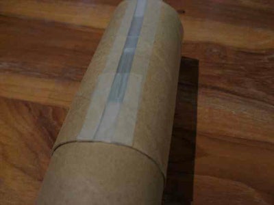

Step 2: Assemble the Body
Start by cutting the toilet paper roll length-wise. Then fit the other roll inside of the one you just cut. Tape it back together so that it is now slightly wider and can just fit the other roll inside.
Take the un-modified roll and cut it in half. This is easiest with an x-acto knife but scissors will work too. Make about 1 inch vertical cuts all the way along the perimeter of one of the halves. Leave about 3/4 inches of space between the cuts.

    kacee3
    kacee3
    10 years ago on Step 2
    I'm confused. Do we need 3 toile rolls? I cut my first roll length wise and then put the other one inside of it and taped them together... but do I need another one to cut in half??
    0
    4_Skin
    4_Skin
    Reply 8 months ago
    No, just that the roll out of the roll you cut. With the roll you take out, cut it in half.
    0
    4_Skin
    4_Skin
    Reply 8 months ago
    *just take the roll out from the roll you put it into.
