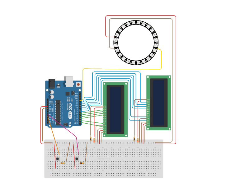

Diagram of these things is shown above. You can use any Bread board. You need 6 Resistors their values is written above in list. You will also need wires for connection. These LCDs you will for display. The method of wiring circuit you can see in next step.

The things you will need. I have shown in previous step so take your bread board wire circuit along with me.
Wiring Steps:
- Place 100 Ohm resistor on upper side of bread board on Negative Line.
- Place 120 Ohm resistor on upper side of bread board on Positive Line.
- Place Push Button (The diagram is shown above)
- Place 10 K Ohm resistor under Push Button
- Connect 100 Ohm resistors (both) to LCD display with 'LED Cathode'
- Connect 120 Ohm resistors (both) to LCD display with 'LED Anode'
- Connect negative terminal of bread board from upper line to 'Read/Write'.
- Connect negative terminal of bread board from upper line to 'Contrast'.
- Connect Positive terminal of bread board from lower line to 'Vcc'.
- Connect another negative terminal of bread board from upper line of bread board to 'GND".
- Do same on 2nd LCD connect all these like previous.
- Connect remaining resistors to negative line of bread board.
- Connect push buttons to positive line.
- Connect Positive & Negative terminal of bread board to "Neo Pixel Ring 24".
Now, you have connected all components.Diagram of this shown above. But arduino is still remaining. Steps of wiring arduino I have shown in next step.
Step 3: Wiring Steps of Arduino to All Components:
Steps are given below:
- Connect push buttons (Terminal22) to A0 & A1 of arduino.
- Connect GND to negative terminal of bread board.
- Connect 5V to positive terminal of bread board.
- Connect D13 of arduino to "Power of " "Neo Pixel Ring 24"
- Connect D7 of arduino to "Register Select" of LCD1.
- Connect D8 of arduino to "Enable" of LCD 2.
- Connect D9 of arduino to "DB4" of LCD 2.
- Connect D10 of arduino to "DB5" of LCD 2.
- Connect D11 of arduino to "DB6" of LCD 2.
- Connect D12 of arduino to "DB7" of LCD 2.
- Connect D1 of arduino to "Register Select" of LCD 1.
- Connect D2 of arduino to "Enable" of LCD 1.
- Connect D3 of arduino to "DB4" of LCD 2.
- Connect D4 of arduino to "DB5" of LCD 2.
- Connect D5 of arduino to "DB6" of LCD 2.
- Connect D6 of arduino to "DB7" of LCD 2.
Diagram of all components after wiring is shown above.
