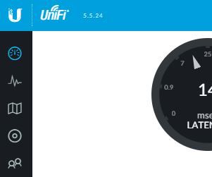

It is also highly recommended you set a static IP on the wireless network configuration so it does not change over time. It is possible the IP may not change if new devices are not regularly connected to the wireless network, but configuring it as static will ensure it does not.
http://www.circuitbasics.com/how-to-set-up-a-static-ip-on-the-raspberry-pi/
