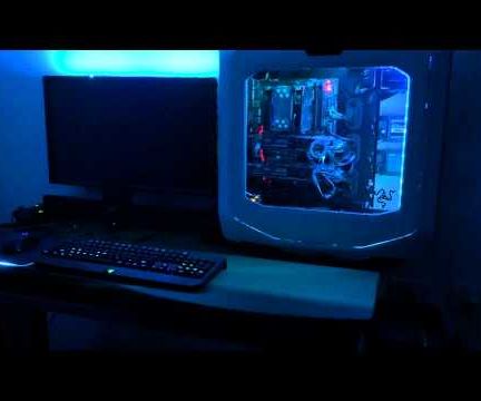

Introduction: Ambilight DFMirage [super Fast Screen Capture and Processing]
yes, all my instructables are about one little project, but as you may have seen, i've evolved really good in these kind of projects.
in this article we're goin to use a software that i've been working on for quite a while, and as the title says"Super Fast", yes as fast as 75 fps with 15% of single processor, no gpu utilization, and best of all, full screen application support.
if you don't know whats the concept of ambilight, please use this link to get amazed by the idea :)
originally provided by Philips, now we clone the idea with the help of some skills.
how do we do such a thing ?
we need a PC with windows OS to do all the processing, digital addressable leds, and a micro-controller to connect the pc with the leds.
Houri, whats different and new in this version ?
well, 1st problem that most people were facing is the full screen applications, games and exclusive screen media players, solved :)
2nd problem is a small noticeable delay, caused by the capturing of image or by the sending data mechanism, also solved.
the capturing method I've used in this project is provided by the amazing guys at demoforge.com
it's super fast capturing method is used for streaming screens across the internet for whatever purposes.
here we are using it to capture our own screen and do the edges processing.

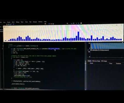

well, it's basically all what i can in do c#, you'll get 2 main things, the led control app server, and the web app, the server acts as:
Audio Output analyzer, led controller with lots of modes, one of them is ambilight with support for bottom leds, gamma correction, others like static color and rainbow, and a server for the web app.

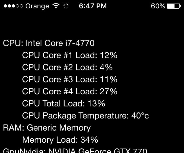

the web app acts as:
remote controller for the leds, hardware monitoring, file transfer from mobile phones to pc and vice versa (works with iphones too), and a keyboard from your mobile to your PC.
