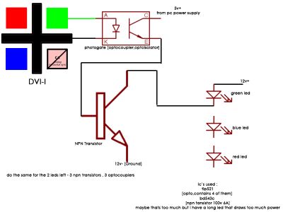

first let's connect the optocoupler on the breadboard, check the datasheet for directions
connect the green or red or blue from your GPU port [DVI-I or VGA] to the Anode of the photogate.
the ground of the photogate must be connected to the ground of the same port ..
now apply 5v+ to the collector..
the emitter of the optocoupler gets connected to the base of the transistor ..
the collector of the 1st transistor get's 12V- [ground], and it's emitter goes to the led cathode color
apply 12v+ to your led common anode
apply the same rules for the rest of the colors ..
Check out the diagram diagram ..
Note: The Optocoupler must be placed in the middle of the breadboard .. because that separates the photogate pins from the collector and emitter ..
