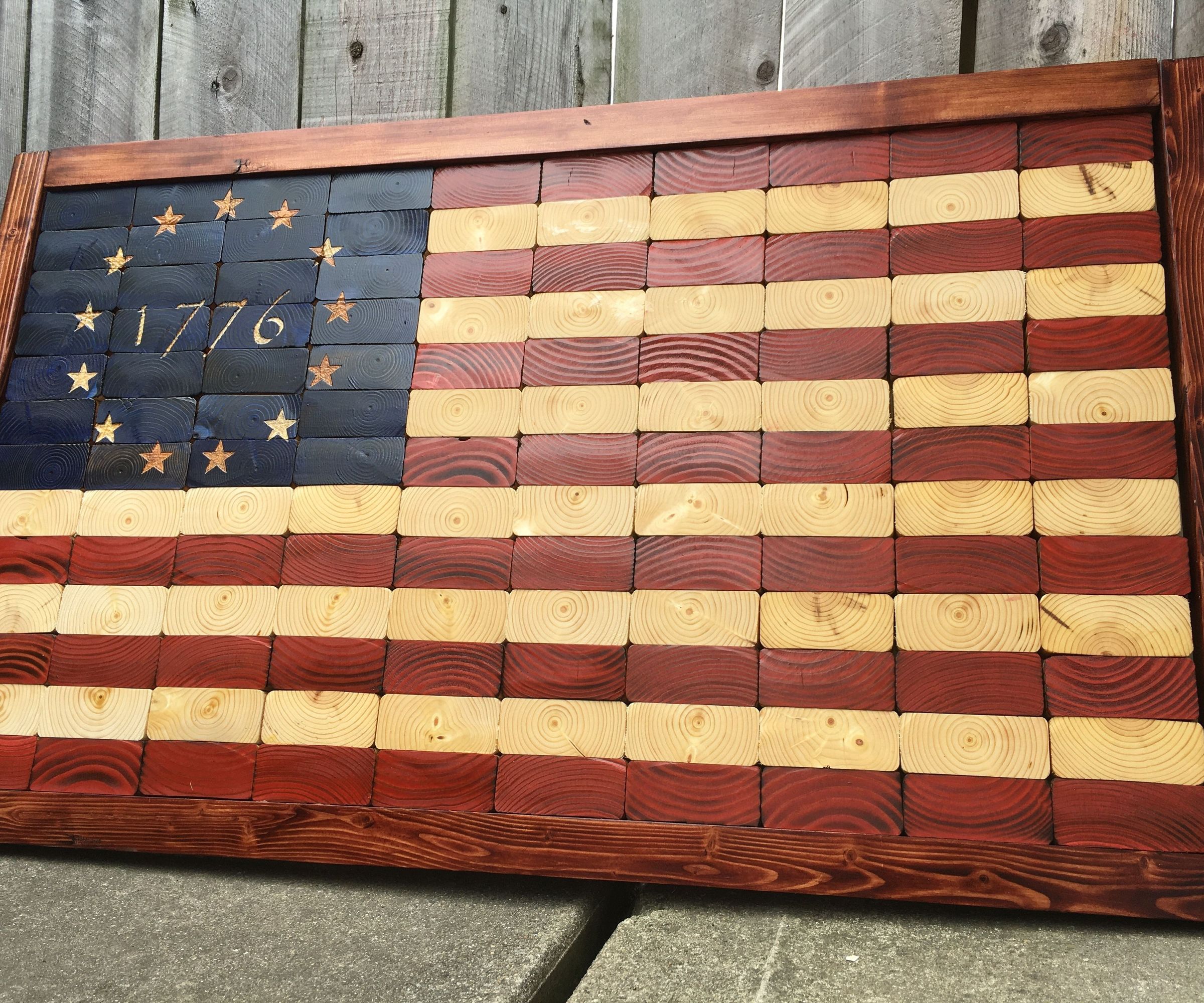

Step 5: Assemble the Union
- To make the Union, take your (3) 14 13/16" boards and glue them together as shown
- Use a set of bar clamps to clamp the boards together tightly.
- if boards begin to push up, gently use a wooden or rubber mallet and tap them flat.
- Wipe off any excess glue and let it dry completely.
- Once dried, use a brad nailer and 1" brad nails and nail the CDX panel cutout from earlier to the back of the Union.

Step 7: Gluing the Stripes
Once the stain is completely dry, layout your stripes in the correct order and move them around a bit to find the best grain pattern and fitment. After you've decided on the layout of your stripes, it's time to glue them to the CDX panel.
- Start with the top short stripe and work your way down.
- Apply glue to the inner edge and the back of the stripe and line it up with the edges of the CDX panel that has the cutout in it.
- Carefully clamp it temporarily in place and brad nail the stripe and CDX panel together from the back of the panel.
- Remove the clamp and apply the second stripe using the same method.
Repeat this process until all stripes have been glued and nailed to the CDX panel.
Clampdown any boards that may have pushed up
Wipe off any excess glue with a wet cloth or rag.
