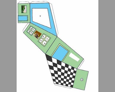

Below is the layout for the Ames Room. In an image editor, the size of this image is 48 inches width x 54 inches height.
Step 2: Divide the Image Equally
This step assumes that you cannot print large. Therefore, the image must be divided equally for easy printing. There are 3 rows and 4 columns.
Each column is 12 inches wide. Each row is 18 inches high.

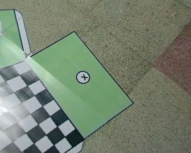

Step 5: Cut Out the Inner Parts
Once the outer portions are removed, stick the different sections with tape or gum. Then cut the inner parts marked with X i.e. the windows, ceiling and observation hole.
Step 6: Fold the Tabs and Walls
Next, fold all the tabs and edges of the walls.
Step 7: Fold the Entire Room
Finally, fold the entire room. This is the tricky part as each edge should meet the adjacent or opposite edge. Using tape or gum, stick the edges together.
