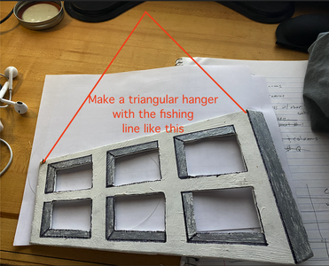

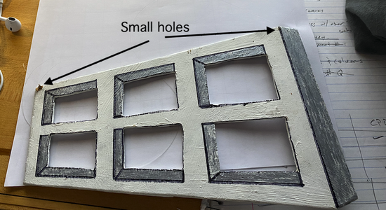

    Step 8: Hang It on a Line
    1. Drill small holes into either ends at the top.
    2. String fishing line through the holes to make a hanger.
    3. Leave enough slack so that you can make a triangle with the fishing line.
