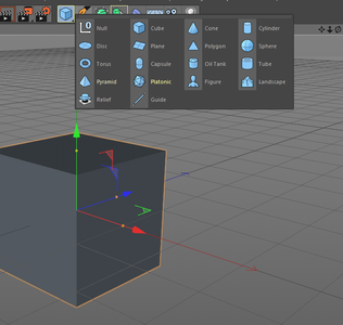

First of all we needed to measure the drive and the board and design the enclosure to accommodate everything, in the cad software we add a cube then set the size to match our measurements then used another cube to cut out the "drive and electronics bay" then we used another cube to make 2 parts to the lid. fnally we cut out "grooves" so it would all lock together then glue. see attached STL for case components
