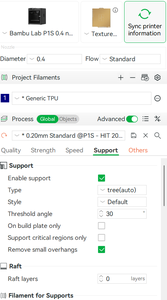

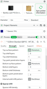

Step 1: Printing the TPU Parts
Print the two TPU parts separately using a 3D printer, according to the settings for TPU material (such as nozzle temperature, print speed, etc..). After printing is complete, allow the parts to cool down fully. Carefully remove the supports using small pliers, making sure not to damage the printed parts.

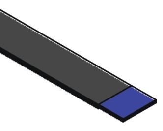

Step 9: Preparing the Bottom Strap | Sew the End of the Strap
First, fold the remaining end of the strap (the side with the female Velcro) in half over itself. (image 1,2)
While it is folded, cut the strap at a 30-degree angle on both sides. (image 3)
Now sew along the edge of the strap, following the angled shape you created, approximately 5 mm from the edge.(image 4)
This is the state the strap should be in at this point (image 5)
