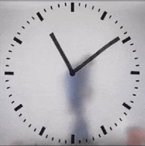

Inspired by the famous Amsterdam Clock at Amesradum, which amazes people by making it look like a man is drawing the clock hands from behind, this project recreates the magic in a compact, aesthetic design. Using a round display, ButtonBoard with a built-in RTC, and a wooden frame, the clock blends technology with art. The man behind the display erases and redraws the clock hands dynamically as time progresses, creating a visually stunning and interactive experience.

The first step in preparing the electronics is to obtain a video of the Amsterdam Clock where a miniature man draws the clock hands for each second and hour. A good source for this is Pixabay, and you can find an example video on YouTube here.
Once the video is obtained, use an MP4-to-GIF converter to extract time-based animations and convert them into GIF format. After conversion, resize the GIFs to 240x240 pixels to match the display's resolution.
Next, the resized GIFs need to be converted into .h files so they can be uploaded to the board. This can be done using the animated_gif_memory tool. After conversion, upload the .h files to the ButtonBoard, ensuring smooth animation playback on the round LCD display.
Once the files are successfully uploaded, verify the animations by running a test program to check the playback of each frame. Make sure the transition between different times is smooth and synchronized with the RTC to ensure accurate time representation.
