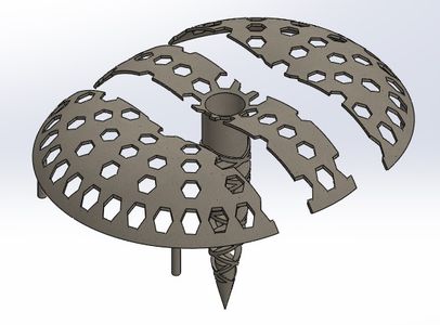

3. There will be some kind of massive overhead roof structure that will serve to collect and bring sun light and rain water into the center of the building. Solar panels mounted on the massive surface of the roof will augment the electricity needs of the building?

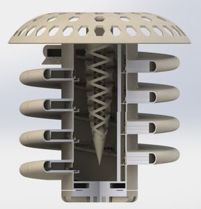

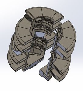

We 'believe' the architectural design we came up with addresses the above issues while solving the problem of land constraint. It is based on the working principle of an earth auger. It consists of a central shaft surrounded by a helical structure.
At the base of the central shaft there is a massive boring head to remove the soil from beneath it. Similarly there are four overlapping boring heads at the end of the helical structure. The entrance lobby block which serves as the main entrance to the building also contains powerful hydraulic ramps to assist in the boring motion of the whole structure.

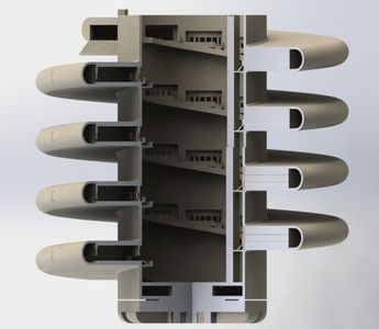

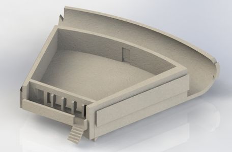

The key to the versatility of our building lies in the modular design of the habitation block. The entrance lobby block stays fixed on the surface. As the whole structure bores into the ground, space is created between the lobby and the first habitation block at the beginning of the helical structure. A new habitation block can then be installed periodically. The sides of the central column are also built up. This allows a scalability in terms of space in the building.
Design

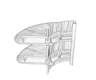

For every complete round in the central shaft there are 10 habitation modules. Access to each habitation block is via the main spiral ramp (1:12 gradient, conform with some building code I think) which runs throughout the building. An integrated elevator and stairwell allows occupants to access each habitation block no more than 5 modules away. At the back of each habitation block is a massive service corridor which also runs throughout the length of the building. It is used to transport the excavated soil to the surface and serves as an evacuation route in case of emergency.
To further drive home the message that 3D printing can be an efficient mean of manufacturing, these modular habitation blocks can conceivably be constructed via concrete 3D printing at an offsite location. The central shaft can also be printed in a similar fashion by a printer running along the circumference of the shaft. We believe large scale implementation of 3D printing here will bring down the cost of constructing the building.

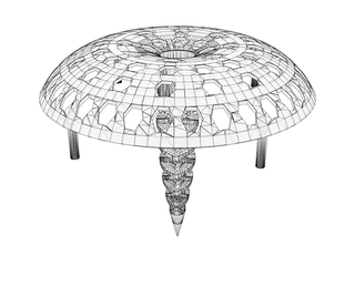

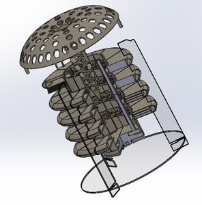

The whole underground building is covered by an umbrella-shaped roof structure. The hexagonal holes are solar panels which will produce power to augment the usage by the occupants. The central column serve as a structure for rain water collection which can be later used for various non-potable purposes, or can be diverted to create indoor rain in the central column. More importantly the column also divert sunlight into all parts of the building during daytime for illumination, thus mitigating the negative psychological impacts with prolonged underground habitation.
The scale of our design here is 1:266. Each habitation approximately contains a living space of 150 square meters. There are 40 modules in the building (for this model), including the 1 entrance lobby block and 2 service and boring block at the bottom of the helical structure.

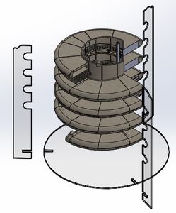

The model was drawn in Solidworks. As the major theme of the building surrounds a corkscrew, we used 'Helix and Spiral' command under 'Curves' to draw a spiral segment of the appropriate length (for the individual module, spiral has a gradient of 1:12 and an angular sweep of 36 degrees is used). Using 'Swept Boss/Bass' we draw the basic shape of the each of the block. Various details were then added later.

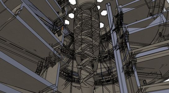

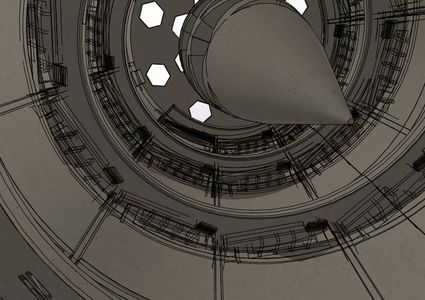

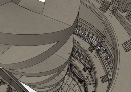

Now here comes the last step of this instructables (well not really a last step as such, but just for fun), let's take a virtual tour of the finished building (the running order of photos for this tour goes from left to right and top to bottom) -

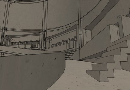

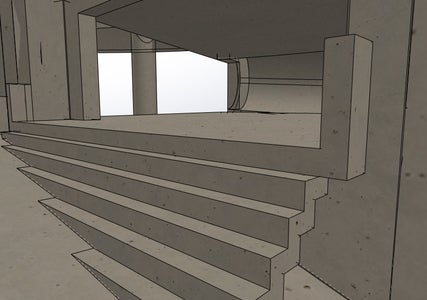

1. Imagine yourself standing below the sprawling flight of stairs leading up to the entrance the building. The building has been burrowing autonomously for nearly a month now, all in all about 40 modules, habitation and service modules included, are already in place. Today is the day when the rest of your team will move in to install all the electrics and the minute trimmings that will finally make the building come alive. You arrived an hour before the work is scheduled to start just to soak in the scene of the empty and bare building for the last time. It is about to get much more bustling in the days to come.
You started by climbing up the bare and unfinished concrete steps towards the main entrance lobby. On your left is the gigantic service corridor that will be sealed with a massive hatch hiding it away from the prying eyes of the occupants.
2. You walked through the entrance lobby and exit the other flight of stairs. You turned around and look at the lobby you just passed through. With the morning sun filtering through the entrance, you reminded yourself that this will be a sight many will see daily on their way out as they go about their daily routine.
3. You slowly stuck your head over the parapet on the other side and was treated with an almost vertigo inducing sight of the whole central column. You can see that all the unfinished and dormant habitation modules. The central inverted spire loomed menacingly right in front of you. Soon it will be fitted with miles of fiber optic cables and computer-controlled reflectors, all in an attempt to replicate the natural movement of the sun across the sky in the central column. Pumping from top side will serve to replicate natural rain in the central column. Greenery will cover whole surface of the spire, giving this spire of light and rain an organic look.
4. You made your way to the back of one of the habitation modules to get a better perspective of the space and view of the outside through the panoramic front windows. When the building is operational, the prefabricated habitation modules will be practically livable before being fitted to the superstructure.
5. You exited the module and continued your tour, only turning occasionally to look back at the long elegant spiral ramp that leads all the way to the entrance lobby.

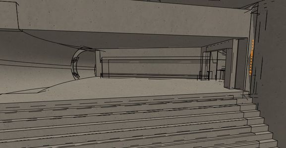

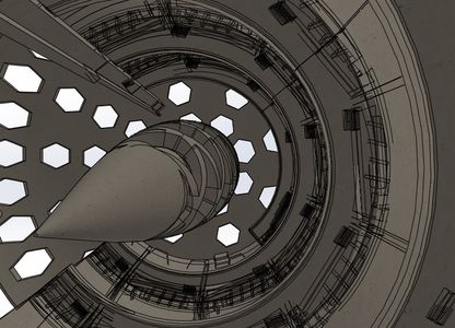

6. You continued your walk all the way to the last module, a service module which houses the massive motors that drives the side boring heads. The hatch to the module is partially open allowing you to hear the soft hum of the churning electric motors. Ahead of you the spiral ramp leads to the entrance of the bottom boring head.
7. You stepped out from the ramp towards the base of the inverted spire and looked up to find a magnificent sight of the spire and the roof. You suddenly heard someone whistled from the direction of the entrance lobby - the rest of your team has arrived, it is time to get to work...
