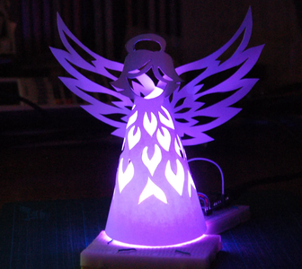

Step 3: The Angel for the Lamp
The lamp housing consists of a silhouette that is bent into a truncated cone.
Figure 3: Angel template finished
The template can be downloaded as PDF file. The black areas in Figure 2 are cut out with a cutter or, better still, a design knife. Once this is done, we roll up the paper, pin the wings together and glue the free back with the adhesive tab.
Figure 4: Cut out template
Figure 5: Angel in blue
Figure 6: Angel blue on red
