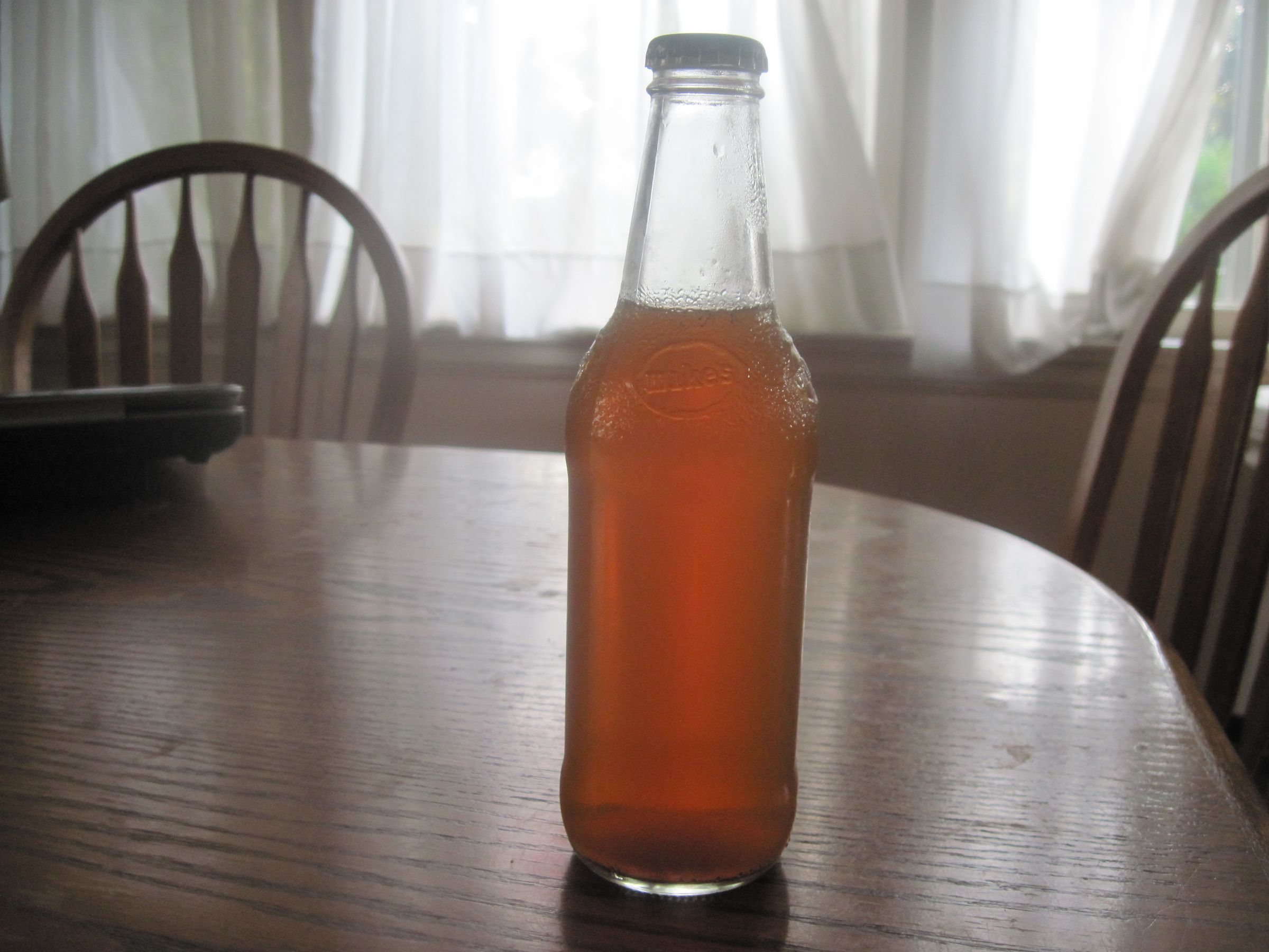

To make this "mud battery" you'll need:
Aluminum Foil
An Empty Container
Insulated Copper Wire
At Least 5 cm of Graphite (taken from a pencil)
Dirt
Water
A Digital Multimeter
A Hand Shovel
