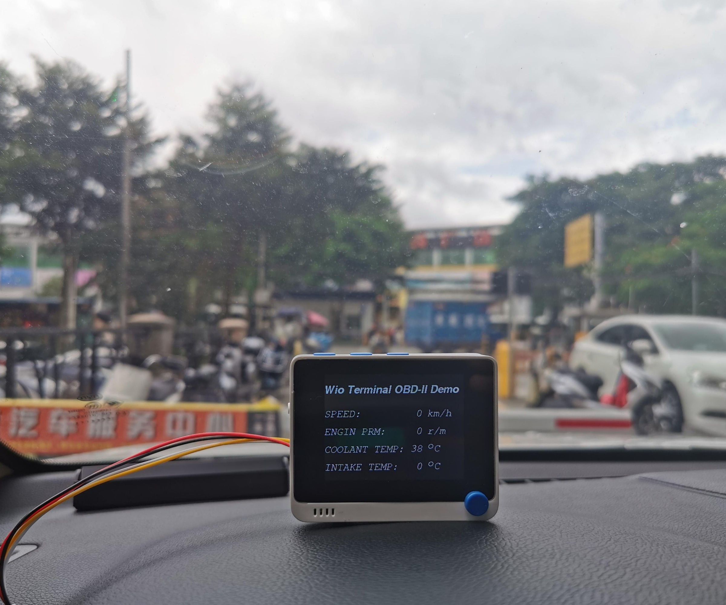

Insert a micro SD card to the board, then you can put the board to OBD-II connector of your vehicle.
OBD-II interface is generally below the steering wheel, you won't miss it.
Step 4: View the Result
You will get 2 file for each trip, an .csv file and a .kml file.
You can open the csv will with MS Excel, to get the speed, rpm as well as some others data.
KML file is the GPS logs, you can open it with Google Earth.
