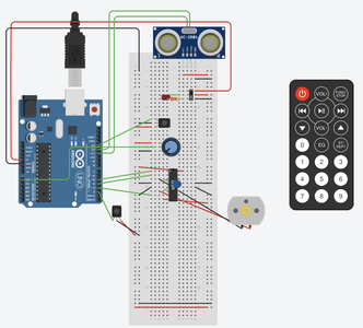

Step 2: Wiring
Connecting power and ground:
  1. Place the slide switch near the top of the breadboard
  2. Connect a red wire from the 5 V pin to the terminal one of the slide switch
  3. Connect the common of the slide switch to the horizontal row that has a positive symbol at the bottom using a red wire
  4. Connect terminal two to horizontal row that has a negative symbol using a black wire
  5. Connect a black wire to the GND on the arduino to the horizontal row with a negative symbol using a black wire at the top of the breadboard
  6. Connect the 220 Ω from the same row as the slide switch that has a negative charge
  7. Connect the green from the same row as the slide switch that has a positive charge
  8. Add an LED so the side that has a bent piece of metal is on the row of the green wire and the straight piece of metal is on the row with the resistor
  9. Add a red wire from the positive symbol on to right to the one on the left at the bottom of the breadboard
  10. Add a black wire from the negative symbol on to right to the one on the left at the bottom of the breadboard
Connecting potentiometer:
  1. Place a potentiometer near the top of the breadboard
  2. Connect a red wire from horizontal row that has a positive symbol to the row that the row of the first pin of potentiometer is on
  3. Connect a black wire from horizontal row that has a negative symbol to the row that the row of the third pin of potentiometer is on
  4. Connect a green wire from pin A0 on the arduino, which is located on the left side, row of the second pin of potentiometer is on
Connecting the motor, H-bridge, and capacitor:
  1. Place the H-bridge near the middle of the circuit, make sure the H-bridge has the semi-circle that should either be at the top or bottom facing the direction towards the slide switch, seen in the picture
  2. Connect a red wire from the horizontal row that has a positive symbol to the row that the first pin on the right is on
  3. Connect a red wire from the horizontal row that has a positive symbol to the row that the last pin on the left is on
  4. Connect a black wire from the horizontal row that has a negative symbol to the line of the pins that are the 4th and 5th rows from the top of the H-bridge
  5. Connect a green wire at the very top row of the H-bridge on the left side to pin 5
  6. Connect a green wire beneath the one just place and connect it to pin 4
  7. Connect a green wire on the second last row on the left side of the H-bridge to pin 3
  8. Connect the black wire that is coming from the motor to the rows of the third pin on the H-bridge on the left side
  9. Connect the red wire that is coming from the motor to the rows of the sixth pin on the H-bridge
  10. Add a capacitor, so that it is in between the black and red wires coming from the motor and the H-bridge
Connecting ultrasonic distance sensor:
  1. Place the ultrasonic distance sensor on the top of the breadboard
  2. Connect a red wire from horizontal row that has a positive symbol to the column that the first pin of ultrasonic distance sensor is on
  3. Connect a black wire from horizontal row that has a negative symbol to the column that the fourth pin of ultrasonic distance sensor is on
  4. Connect a green wire from pin 11 on the arduino to the row of the second pin of ultrasonic distance sensor is on, which states "trig"
  5. Connect a green wire from pin 12 on the arudino to the row of the third pin of ultrasonic distance sensor is on, which states "echo"
Connecting IR receiver:
  1. Place the IR receiver on the middle of the breadboard
  2. Connect a green wire from pin 13 on the arudino to the row of the first pin of IR sensor is on
  3. Connect a black wire from horizontal row that has a negative symbol to the row that the second pin of IR sensor is on
  4. Connect a red wire from horizontal row that has a positive symbol to the row that the first pin of IR sensor is on
Connecting IR sensor module:
  1. Place the IR sensor module on the bottom of the breadboard
  2. Connect a green wire from pin 2 on the arudino to the row of the first pin of IR sensor module is on
  3. Connect a black wire from horizontal row that has a negative symbol to the row that the second pin of IR sensor module is on
  4. Connect a red wire from horizontal row that has a positive symbol to the row that the first pin of IR sensor module is on

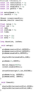

In a easier way to see and copy the code is:
#include <IRremote.h>
const int controlPin1 = 3;
const int controlPin2 = 4;
const int enablePin = 5;
const int potPin = A0;
int motorSpeed = 0;
int recvPin = 13;
IRrecv irrecv(recvPin);
decode_results results;
float value = 0;
float rev = 0;
int rpm;
int oldtime = 0;
int time;
int trig = 12;
int echo = 11;
long duration, inches;
 void setup()
 pinMode(controlPin1,OUTPUT);
 pinMode(controlPin2,OUTPUT);
 pinMode(enablePin,OUTPUT);
 digitalWrite(enablePin,LOW);
 pinMode(13,INPUT);
 Serial.begin(9600);
 irrecv.enableIRIn();
 attachInterrupt(0,isr,RISING);
 pinMode(trig, OUTPUT);
 pinMode(echo, INPUT);
 void foward()

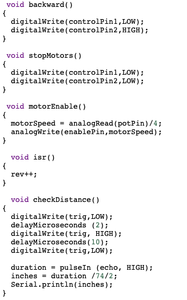

 void backward()
 digitalWrite(controlPin1,LOW);
 digitalWrite(controlPin2,HIGH);
 void stopMotors()
 digitalWrite(controlPin2,LOW);
 void motorEnable()
 motorSpeed = analogRead(potPin)/4;
 analogWrite(enablePin,motorSpeed);
 void isr()
 rev++;
 void checkDistance()
 digitalWrite(trig,LOW);
 delayMicroseconds (2);
 digitalWrite(trig, HIGH);
 delayMicroseconds(10);
 duration = pulseIn (echo, HIGH);
 inches = duration /74/2;
 Serial.println(inches);

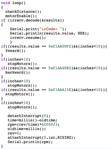

void loop()
 checkDistance();
 motorEnable();
if (irrecv.decode(&results))
  Serial.print("irCode: ");
  Serial.println(results.value, HEX);
  irrecv.resume();
if((results.value == 0xC1AA0DF2)&&(inches<10)){
 foward();
if(inches>10)
  stopMotors();
if((results.value == 0xC1AA4DB2)&&(inches<10)){
 backward();
if(inches>10)
  stopMotors();
if((results.value == 0xC1AAA15E)&&(inches<10)){
 stopMotors();
if(inches>10)
  stopMotors();
  detachInterrupt(0);
  time=millis()-oldtime;
  rpm=(rev/time)*60000/3;
  oldtime=millis();
  rev=0;
  Serial.println(rpm);
