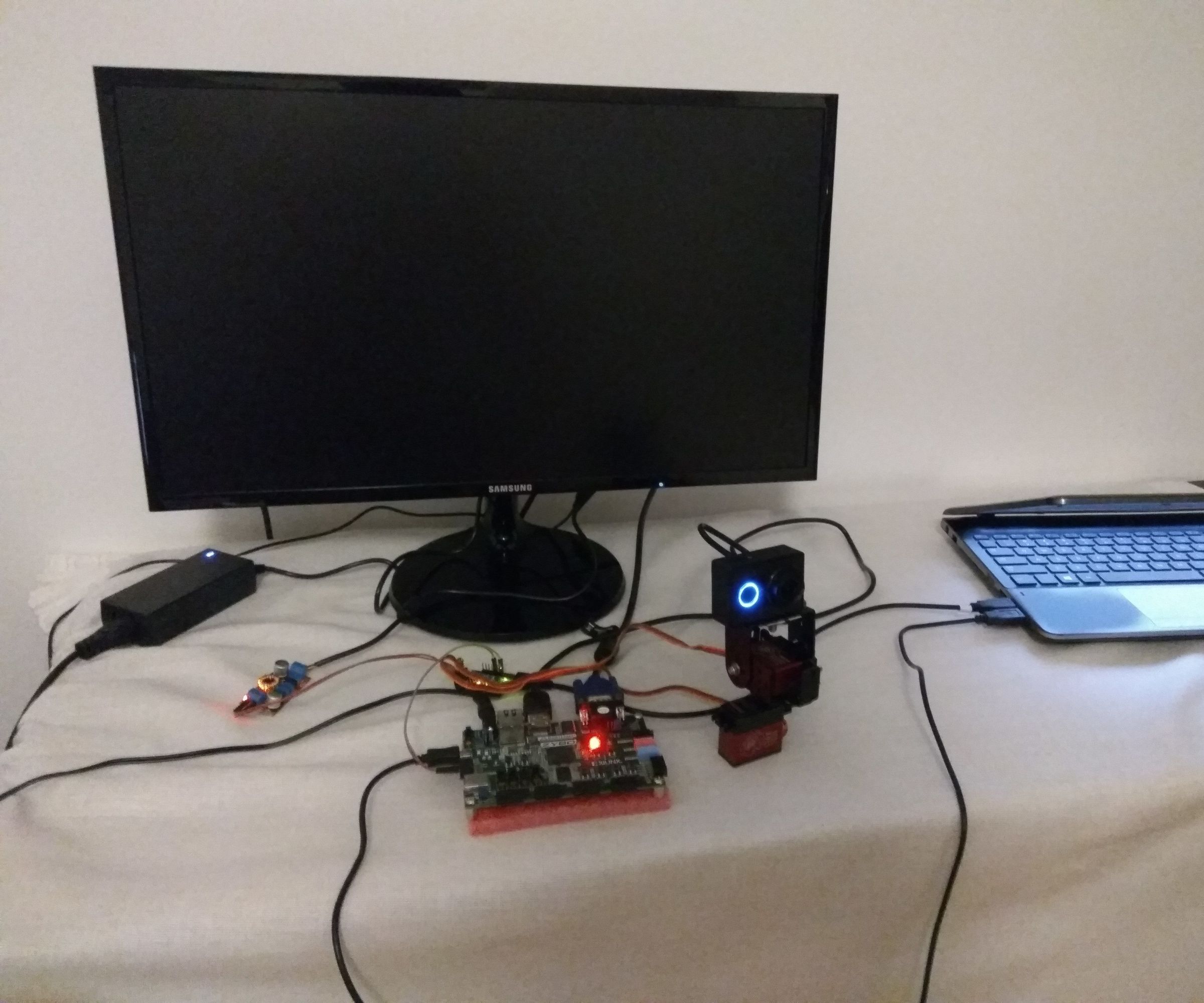

Step 3: The Required Equipment
To run our project you require:
- Zybo development board from Digilent,
- a camera with HDMI output (currently the used video I/O design supports 720p resolution i.e. 1280 x 720 ). In our experiments we have used a Sony HDR-CX280 camera,
- LCD screen with 1280 x 720 pixel resolution support and VGA input,
- wires: x1 HDMI (camera-Zybo), x1 VGA (Zybo-LCD), x1 USB mini/standard (Zybo programming),
- power supply for the Zybo board,
- Vivado and SDK software (we used the 2015.4 version).
Step 4: Connecting Hardware
Connect your video camera to the Zybo board with a proper HDMI cable (in our case mini HDMI to HDMI). The camera needs to have HDMI output enabled and set 1280x720 resolution (720p). Plug in the VGA cable to Zybo board and some screen with VGA input.
The Zynq configuration will be downloaded by a USB cable, so connect the board with your PC via mini USB to USB cable and make sure the required cable drivers are available.
