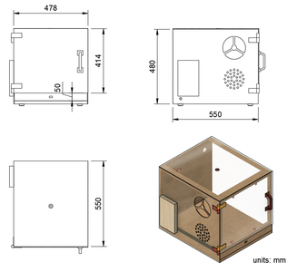

Step 2: Diagrams and Dimensions
Above you can see some dimensions of the enclosure.

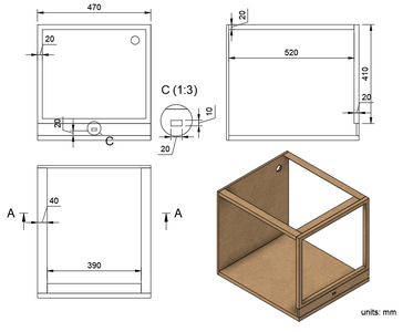

Step 3: Enclosure MDF Panels
Let’s start the build from the back, bottom and front MDF panels. You can see above a diagram with all the dimensions. I used 10mm thick panels. Note that for the base I used two 10 mm MDF panels to get a total thickness of 20 mm. There are two holes: one in the back for fume extraction, the other on the front panel for the cables of the printer’s control panel. To attach the panels you can use screws and/or glue.
Here is a cut list for this section:
Name | Dimensions | Qty | Material
Bottom | 54 cm x 47 cm | 2 | MDF 10 mm
Back | 48 cm x 47 cm | 1 | MDF 10 mm
Front | 47 cm x 5 cm | 1 | MDF 10 mm

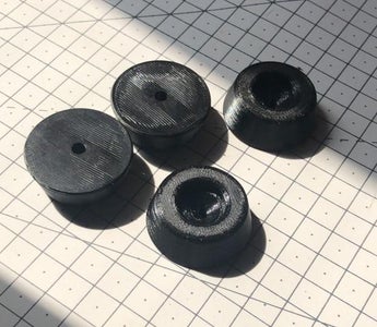

Step 4: Add Feet
After gluing the two panels for the bottom, you can attach the 3D printed feet to the base using 4 x 25mm wood screws. Pre drill each hole before inserting the screws.

Step 6: Complete the Internal Frame
Now we add the rest of the MDF pieces for the internal frame. See the dimensions above.
Note the 45 degrees bevel on the top beams which will be used later to install the LED strip.

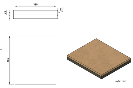

Step 7: Printer’s Base
For the printer’s base I’ve used two 10 mm MDF panels glued together to form a 20 mm thick panel and I’ve placed it over a sheet of foam of the same size. The MDF base will provide a solid and flat ground for the printer, while the foam layer below will absorb vibrations.
MDF Base | 46 cm x 39 cm | 2 | MDF 10 mm
Foam Base | 46 cm x 39 cm | 1 | Foam 30 mm

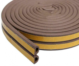

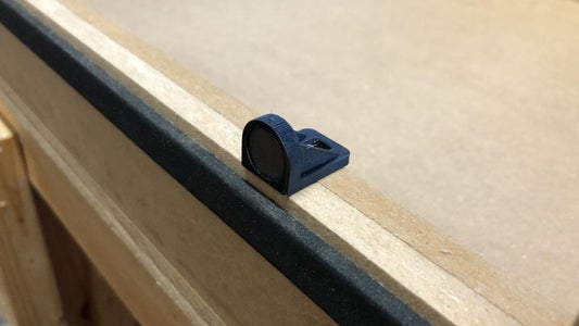

The front door is attached to the enclosure with two 3D printed hinges and is kept closed against a strip of windows seal by some magnets. This will ensure air tightness and allow to easily remove the door by just pulling it out of its hinges. The ability to remove the door is very important to control temperature during warm days when the air vents may fail to cool down the enclosure.
For the front door you need to cut a plexi panel of 48 cm x 41 cm and some 3D printed parts: 2 hinges, the handle and 5 magnet holders. You will need also a strip of windows seal, 5 mm wide, like the one in the image above. Use only one of the couple of strips by splitting the twos in the middle.
Apply the seal strip on the door frame, insert the magnets into the holders, install the holders to the frame with some small wood screws, then glue the hinges and the handle on the plexi panels. To glue the 3D printed parts to plexiglas you can use glue for plastic, two component epoxy glue or super glue. Remember to sand the surfaces before gluing them to ensure a strong join.
At this point you can close the door and mark where to attach the magnets that will match the ones already installed on the door frame. Once you attach the magnets to the door, tune the magnet holders distance from the door to allow the door to close completely and stick to the seal.

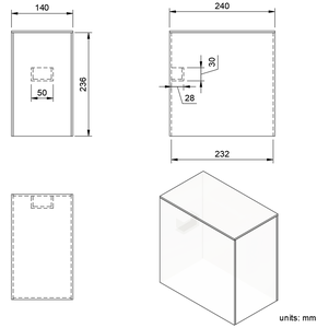

Step 10: Spool Enclosure
The spool is located on top of the enclosure, on a 3D printed spool holder. I wanted to protect the spool from dust and humidity as well as the printer itself, so I designed this little plexi box to be simply placed over the spool. I sealed the walls with silicone and attached a strip of 5 mm wide window seal to the bottom edges. I added a little pocket on the back to hold some silica gel bags to absorb humidity. I also added a 3D printed holder for a digital hygrometer attached on the top front of the box.
Here is the cut list for the spool enclosure:
Sides | 23.2 cm x 23.6 cm | 2 | Plexi 4 mm
Top | 14 cm x 24 cm | 1 | Plexi 4 mm
Front/Back | 14 cm x 23.6 cm | 2 | Plexi 4 mm
Pocket sides | 28 mm x 28 mm | 2 | Plexi 2 mm
Pocket bottom | 50 mm x 28 mm | 1 | Plexi 2 mm
Pocket front | 46 mm x 28 mm | 1 | Plexi 2 mm

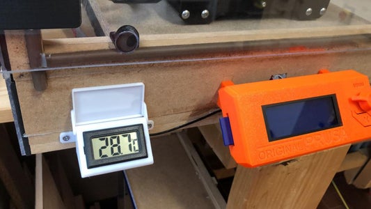

Step 13: External Display and Thermometer
We want to control the printer while it is closed inside the box, so we need to move the control panel outside. If you followed the steps above, you have already unmounted the control panel and drilled the holes for the attachment screws on the enclosure's MDF front panel.
Now unplug the two ribbon cables from the control panel, insert them inside the hole in the front panel and reattach them. Finally mount the control panel to the enclosure with its screws.
At this point you can install the digital thermometer. You need to 3D print some parts: the thermometer holder with its lid and the probe bracket.
Insert the digital thermometer inside its holder. Attach the holder to the front panel with some tiny wood screws, then insert the probe cable inside the front panel central hole. Insert the cable under the printer’s base foam, then insert the probe in its bracket which you have attached to the bottom wall with some tiny wood screws.
At this point you can seal the hole on the front panel with some silicone to ensure air tightness for the enclosure.

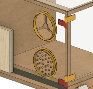

Step 14: Air Vents

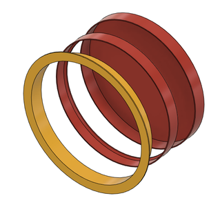

The air flow system is based on air being extracted from the pipe on the back wall, attached to the fume extraction system. New air is let in from two air vents on the left wall. The propellers on the air vents are used as air flow indicators. There are two air vents with different designs because I first designed the bottom one, then realized I wanted the air to flow above the plate and made the upper vent experimenting with a different design.
If you followed the previous steps, you have already made some cuts for the air vents on the left plexi panel. Now you need to 3D print the air vent caps which are made of three parts: a base, a filter holder ring and a cap. Glue the base to the external side of the plexi panel.
When ventilating the enclosure, we don’t want any dust to come inside. So we need to install some filter sheets on the air vents. I made mine using a bag from my shop VAC (a Kärcher WD).
This bag is made of a three layered filter. I removed the central layer to allow less resistance and a better air flow.

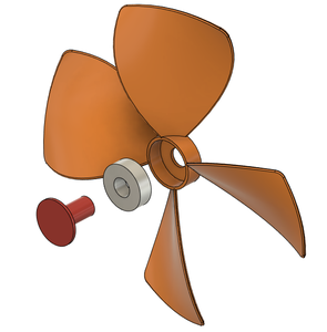

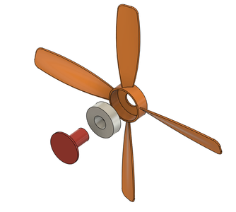

Now it is time to install the propellers on the inside. You need to 3D print the axis and the propeller. You also need a bearing 19 x 8 x 6 mm for each propeller.
I suggest to put some oil on the bearings before installing them, they need to have very low friction for the propellers to rotate even with a small air flow.

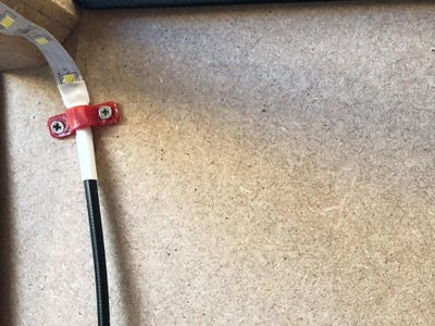

Step 15: LED Strip
I used a strip of LEDs with 12V input but the PSU of the Prusa i3 mk3s has an output of 24V. So I installed a little DC-DC 24V to 12V converter to power the LEDs with the correct voltage. I routed the output wire from the converter into a unipolar switch button. I attached the converter on the back of the wooden block and the button on top of it for an easy reach. In the pictures above you can see the final installation and a schematic of the electric connections.
I inserted the wires for the LED strip in the hole for the PSU, attached the wires to the LED strip and the strip cable to the bottom wall with a little 3D printed bracket. Then I attached the LED strip to the left, front and right edges of the ceiling with its own adhesive.
Now that all the wires have been routed through the hole near the PSU, we can close it with silicone for air tightness.

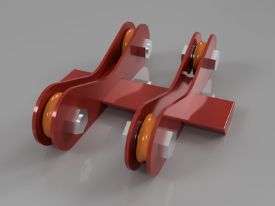

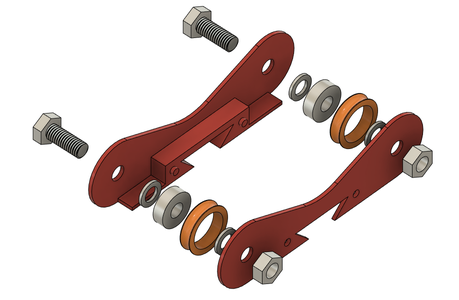

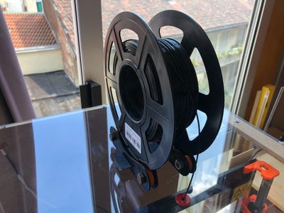

Step 16: Spool Holder
For the spool holder you need to print some 3D parts, then for each rail you need:
  • 2 bearings 19mm ext diam, 8mm hole diam, 6mm thick
  • 2 nuts and bolts M8, 20mm length
  • 4 washers, 8mm hole diameter
Install everything following the image above.

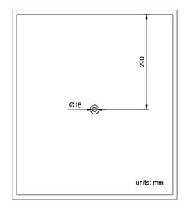

At this point, to complete the spool section, you can drill a hole in the top panel to insert the 3D printed filament hole plug. You need to drill a 16 mm diameter hole. See the drawing above for its positioning.
