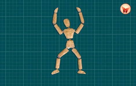

Step 1: Ergoman Gif
The Ergoman :)
Step 2: Torso
The first thing I did was the torso, for this
1. I took a cork
2. I cut it to the height I wanted it to be
3. I cut the front and back
4. I cut the sides a little slanted
5. With small cuts I sought to soften the edges
Step 3: Hips
For the hip, I did the same steps as the torso, but making the piece smaller.
Step 4: Head
1. I took a cork
Step 5: Arms and Legs
For the arms and legs I sought to make cylinders that I later softened with small cuts
Step 6: Hands
The hands were made with part of the leftover corks that I had cut
Step 7: Feet
Step 8: Joints
Before starting the project I put a little Vaseline on the head of all the pins so that they would not stick to the silicone.
For the creation of joints
1. I cut the pin to the size I needed it
2. I put the pin in one of the pieces
3. I put hot silicone on the other piece
4. I inserted the head of the pin into the silicone
5. When the silicone cooled down I started to move it so that it would work as a joint.
