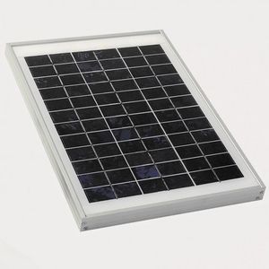

Step 1: Choose a Solar Panel
In this project we are using a 5W noncrystalline solar panel which cost me around 5$ .

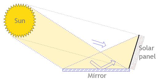

Most of the time a solar panel is working well below peak power, on hazy days and when the sun is lower in the sky, early morning, late afternoon for example. The light levels are just not high enough, so to boost the light level I tried aligning a mirror to reflect more light onto my solar panel. It worked really well and after a bit of experimentation I found that placing a mirror at least twice the size of the solar panel on the ground in front of the panel could boost the output by as much as 60%.
Using a bigger mirror can reflect light onto your panel over a longer period during the day so you don't need to track the sun, just face your panel and mirror due south.
1) first we will focus the sun light on the solar panel surface through mirror Which cost me around 0.34.
So let's see how it works, If it works fine than we will note the temperature of panel and find the temperature of it at peak time.

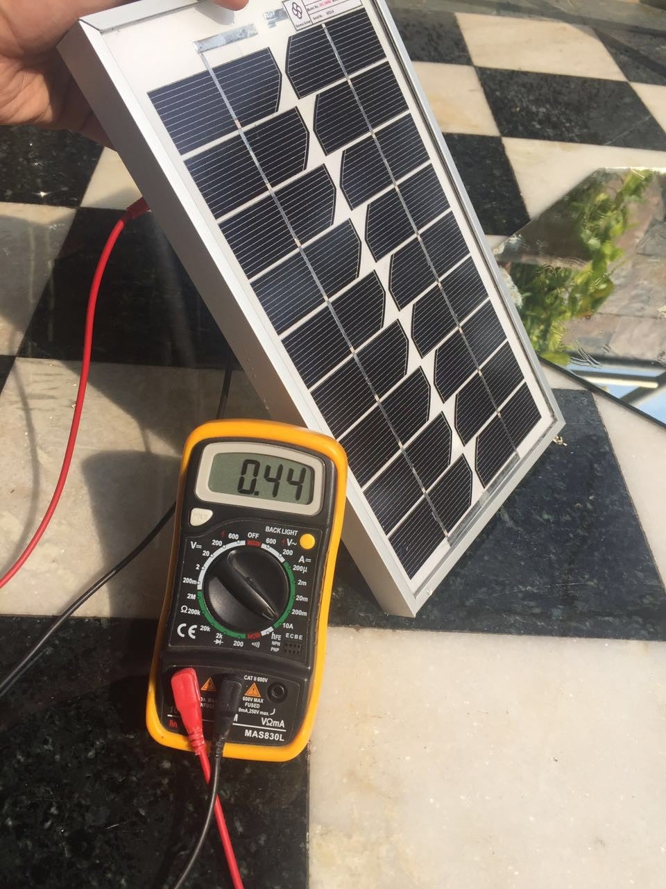

I bought a really cheap solar panel for 5$ to test this idea, above are some pictures showing what I did and the meter readings just to show that it really does work. Pictured below is the 5w solar panel facing south just placed on a Floor. The meter is showing amps, that's approximately watts, it's late August and even on a very sunny day the panel is only producing just over half it''s peak power.
In the picture above you can see how the mirror reflects light onto the solar panel. The panel produced amps, about watts, very close to the maximum rated output for this panel.
If you use a large mirror there is no need to align it to reflect light onto the solar panel just drop it on the ground in front of the panel for an instant 60% power boost.
This is probably one of the cheapest and easiest ways to boost the power of a small solar panel, but this method does have some limitations:
You can use more mirrors to reflect more light onto the solar panel and increase it's power further but on a sunny summers day the extra light can build up a lot of heat that may damage the panel. In July I had my 1.5w panel running at double its rated power for twenty minutes, it got so hot you couldn't touch it!
Placing mirrors either side of the panel to reflect doesn't work well because as the sun moves west it will cast a shadow across the panel. The only place that the mirror won't cast a shadow at any time in the day is on the ground in front of the solar panel.
On a dull day the mirror doesn't give much of a power boost at all, I tested a panel on a dull day in October; it produced 2% of its rated power, adding a mirror made no difference.

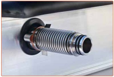

Now we have to take copper or aluminium pipe which we will assemble at the back side of the solar panel through which we will pass the water,Note ( The thickness of the pipe should be minimum to prevent the loss of energy)

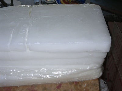

When installation of pipe is done at the back side of the solar panel, We will arrange for the "Phase Changing Material"
PCM : This material stores the heat in to itself and changes its phase from solid to liquid and when the surrounding temperature falls down it releases the heat and again change its phase from liquid to solid.
I am using (PCM) Paraffins, typically, are derived from petroleum and have a waxy consistency at room temperature. Their melt point temperatures range between -8°C and 40°C. They have good thermal storage capacity and are proven to freeze without supercooling. They also have the advantage of chemical stability over many heating and freezing cycles. They are non-corrosive and are compatible with most encapsulation materials. But they have a limited range of melting points and their cost is linked to unstable petroleum prices. And, like all fossil fuels, petroleum has significant environmental costs. Many paraffins are hazardous to health and the environment. Some can injure skin, eyes and mucous membranes. Some have narcotic effects if inhaled. Hexadecane, a petroleum alternative to PureTemp 18, is one example.
BE CAREFUL I AM USING PARAFFIN BECAUSE FOR FURTHER RESEARCH I HAVE TO UTILIZE THE WHOLE SETUP FOR MY RENEWABLE ENERGY AIR-CONDITIONING SYSTEM.
but you can use the water based PCM.( It will work gud)
NOW IF WE HAVE TO USE THE HOT WATER FOR HEATING VEGETABLE OR FOR FOOD PURPOSE THAN I HIGHLY RECOMMEND TO USE WATER BASED PCM AS IT IS NOT POISONOUS, OR HAZARDOUS TO HEALTH . PLEASE DO NOT USE PARAFFIN.
