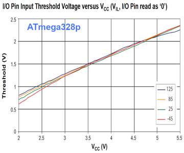

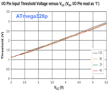

Step 8: The ATmega Hysteresis Mystery
The ATmega328P datasheet has plots (shown above) of the rising and falling threshold voltages for its digital inputs for varying supply voltage and temperatures. The manual testing in Step 7: GPIO - Digital Input Threshold Voltage of Arduino Comparison in Detail: UNO R3, Leonardo, UNO R4 Minima and UNO R4 WiFi using a potentiometer confirmed the ATmega chips do have hysteresis on the digital inputs, particularly the ATmega328P on the Arduino UNO R3. This leaves a mystery of why this automated testing using the UNO R4 DAC does not show the hysteresis.
Creating a waveform using analogWrite() on the Arduino UNO R4 DACs produces very noisy output. There are spikes when the DAC output is set which appear to be roughly towards the midpoint voltage. These spikes can defeat a schmitt trigger which provides the hysteresis. These brief spikes may not be very apparent on all oscilloscopes without zooming in by setting a shorter timebase. John Lincoln kindly provided a clear view of these spikes from a 10Hz sinewave from an R4 DAC on a Siglent oscilloscope in the Arduino forums, shown above.
