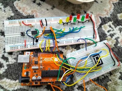

Hello, my name is FatimaFarooq , I will be presenting my final project. For this project, I have created a LED chaser game. In this game, the LEDs will be flashing in consecutive order. On the serial monitor on the arduino, you will be given a colour. With the given, you will need to press the button at the same time the LED chaser passes over that colour. For example, if you are given red, you will need to press the pushbutton right as it passes over red. This circuit works through the usage of a 555 timer, a decade counter, and an arduino. The 555 timer and decade counter control the LED chaser, and then the arduino receives the signal from the LEDs and compares it to the push button. Now that you know how this project works, let's move onto the materials.

Step 2: Wiring
For the wiring, the Tinkercad and the schematic above can help with connecting all of the components together.
1. Connecting the Power Source
Since there will be multiple components that require both power and ground, the first thing to do is to connect the VCC and GND to the breadboard so that it flows throughout.
2. Building the LED Chaser: Part 1 (555 Timer)
The entire basis of this project is the LED chaser, and without it, there would be no point in the game. Using either the schematic or Tinkercad above, you will be able to build an LED chaser. To start off, you need to connect power of the 555 timer to VCC and ground of the timer to ground. Next you want to connect pin 2 (trigger) and pin 6 (threshold) of the timer together. After that, you need to connect pin 4 (reset) to pin 8 (power), so that pin 4 gets power. Next, you need to place a 10k ohm potentiometer on pin 8, pin 7 (discharge), and pin 6. This potentiometer will allow you to change the speed of the LED chaser. The last part of the 555 timer is a electrolytic capacitor, which connects both pin 1 (ground) and pin 2. These are all of the main connections of the 555 timer. There is one last connection, but that brings us to the next component, the decade counter.
3. Building the LED Chaser: Part 2 (Decade Counter and LEDs)
Continuing off of the previous paragraph, the last connection of the 555 timer is pin 3 (output), which connects to pin 14 (clock) of the decade counter. Since the 555 timer is configured in the astable mode, it sends that pulse to the decade counter, which will soon send it to the LEDs. Now for the decade counter, you need to start off just like the 555 timer, and connect both power and ground to pin 16 (power) and pin 8 (ground). Other than the main outputs, there are two other connections, being pin 15 (reset) and pin 13 (clock enable) to ground. All that's left to do is connect all of the outputs depending on how much LEDs you are using. Since I used 7 in my project, I connected outputs 1-7 to the anodes on the LEDs (look at Tinkercad above). The last thing you need to do before completing the LED chaser is connect ground to each of these LEDs. In my circuit, I have a 1k Ohms resistance going through each of the LEDs.

In the image below, you can see where the pins are connected. Furthermore, the schematic above has a detailed view of which pins connect to which components. In the connected pins, you might notice that some pins are connected to the output. These pins are connected to the output on the decade counter, to receive a pulse to compare with the button. It's with this that we will be able know when to add the score, by comparing the LEDs and the pushbutton. On the 4 digit seven segment display, there are resistors attached to the pins. All of these resistors are 560 Ohms and reduce the voltage going into the pins on the display. Lastly to finish off the wiring, there is the pushbutton. The pushbutton has 4 pins, the bottom left connecting to power, the top right connecting to ground through a 10k Ohm resistor, and the bottom right pin connecting to the Arduino pin. Now that the wiring is complete, let's move onto then coding.

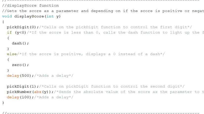

Step 6: Coding: Part 4 (Functions for Displaying the Score)
Now onto the last part of the project, the functions for the score. In the Loop function section, I mentioned a displayScore function. This is first function I will be explaining.

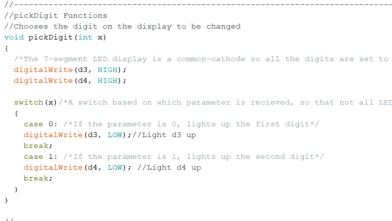

The function starts off by taking the score as its parameter. It then calls on the pickDigit function with a parameter of 0. This function lights up the specific digit that is gonna be changed. Since this function was called with a parameter of 0, that lights up the third digit from the left. Since that digit is now lit up, it can be changed. The next part of the function has an if statement that checks to see if the score is negative or not. If the score is negative, then the dash function is called upon, which lights up the negative sign on digit that was chosen earlier. If the score is not negative, it lights up a zero instead of a dash. A delay is added afterwards. Next, the pickDigit function is called upon again, now with a 1 as its parameter. Since its parameter is now one, the previous digit is turned off from being controlled and the first digit from the right is turned on.
Next, the pickNumber function is called upon with the absolute value of the score as the parameter. The pickNumber function takes the score as the parameter, and calls upon case with the corresponding number. Within each case is the corresponding function that lights up the number. For example, in case 1 is the function that lights up the number 1 on the display. Since the new digit was turned on, the pickNumber function lights up that digit depending on what the score is. If it is negative, the absolute value is sent so that the program understands. Finally, another delay is added, which completes all of the code for this project.
