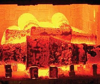

Above: (Top) Microscopic view of the different phases of carbon steel. (Bottom) The iron / carbon phase diagram, which shows temperatures at which phase change occurs.
Heat treating works by exposing carbon steels to a range of specific temperatures for a prescribed period.
Carbon steel's molecular structure is crystalline. Exposure to hot and cool temperatures will change the shape, or phase, of these crystals. Holding, or "soaking" the steel in these temperatures will further change the shape of the crystalline structure. The temperatures at which this process begins is called the steel's critical temperature. The range in between the critical temperature and the upper melting point is called the steel's transformation range.
There are a number of phases that the steel can potentially contain, and each exhibits its own set of properties. These properties can be beneficial in different ways to the material's application. The different phases are called: austenite, ferrite, cementite, martensite, banite, and pearlite (technically not a phase, but a mixture of ferrite and cementite.)
That's right! By controlling a carbon steel's exposure to specific temperatures, we can make that steel harder, softer, or tougher. This greatly increases the material's durability and makes carbon steels very suitable for industrial applications.
