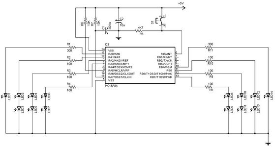

The neat thing that this means is that I can present a single die display using only 4 output pins on the micro.  To display 2 separate dies, I only need 8 pins.
Step 2: Driving LEDS Using a Microprocessor
Driving LEDs with a PIC microcontroller is a simple exercise. Because the outputs can drive 50mA, we can drive the LED directly with a series current limiting resistor to protect the LED. The diagram below shows typical connection details.
The value of the current limiting resistor can be determined by using the equation;
                    Rser = (Vcc – VLed) / Iled
Where;
                   Rser Value of series resistor
                   Vcc Supply Voltage (5V)
                   VLed Forward voltage drop of the LED (typically 1.2V)
                   Iled Led Current (Typically 20mA)
So, for the single LED in the dice pattern, we need;
                    Rser = ( 5 - 1.2 ) / 20*10-3 = 220R.
And in the case of our dual LEDs, Rser becomes;
                    Rser = (5 - 2*1.2) / 20*10-3 = 100R.

Now that we have designed the inputs and the outputs, all that remains is to implement a power supply, and supply some sort of clock circuit to the microprocessor.
The most simple power supply we can have is to simply use 4 ‘AA’ batteries. This provides 6.0V. If a series reverse polarity protection diode is used, the available supply voltage drops to approx 5.4 Volts, which is within the PIC’s rated input voltage range of 4.0 – 6.0 volts.
Traditionally, microprocessor systems have used some sort of 3 terminal voltage regulator to ensure that 5.0 volts is available to the CPU. We decided not to use a 78L05 or similar 3 terminal voltage regulator, as the 4mA stand by current drawn by the regulator would swamp the sleep current of the PIC (approx 7uA), and would cause poor battery life.
In our circuit, the microprocessor consumes approximately 7uA while it is in its standby ‘sleep’ mode. So in theory, a set of 4 ‘AA’ alkaline batteries with a capacity of approximately 800mA/H should be able to last about 114,000 hours (13 years… I suspect that the batteries will die of their own accord LONG before this time !!) while in sleep mode. Of course, current consumption will increase to about 120mA during operation.  As an aside - the project is STILL USING the same batteries I put in it in the year 2000 - And they haven't started leaking.
The PIC range of microprocessors can use a variety of clock circuits, ranging from crystal controlled oscillators, through to RC (resistor/capacitor) networks. If accurate timing is required, a crystal oscillator is recommended. In our application, we are not concerned about speed and clock accuracy, so we will use a RC oscillator for this design.
Our RC Oscillator is implemented by using a 10K resistor and a 1000pF Capacitor as shown in the following diagram;  (note the the cap in the diagram is wrong - it should read 1000pf)

Port A(0) - Centre LED
Port A(1) - Corner LEDs (1) and (3).
Port A(2) - Corner LEDs (2) and (4).
Port A(3) - Middle LEDs (5) and (6).
To display the pattern for a 6, all corner LEDs, and all middle LEDs are on, but the centre LED is off. This equates to bit pattern of b’00001110’. So, to display a 6, we simply execute the instructions;

Step 11: The Completed Circuit Diagram and Code for the Microcontroller
Here is the full circuit diagram, as well as the source and hex files for the micro.
Many thanks to "jman 31' who redrew the schematic to fix some irritating errors. :-)
