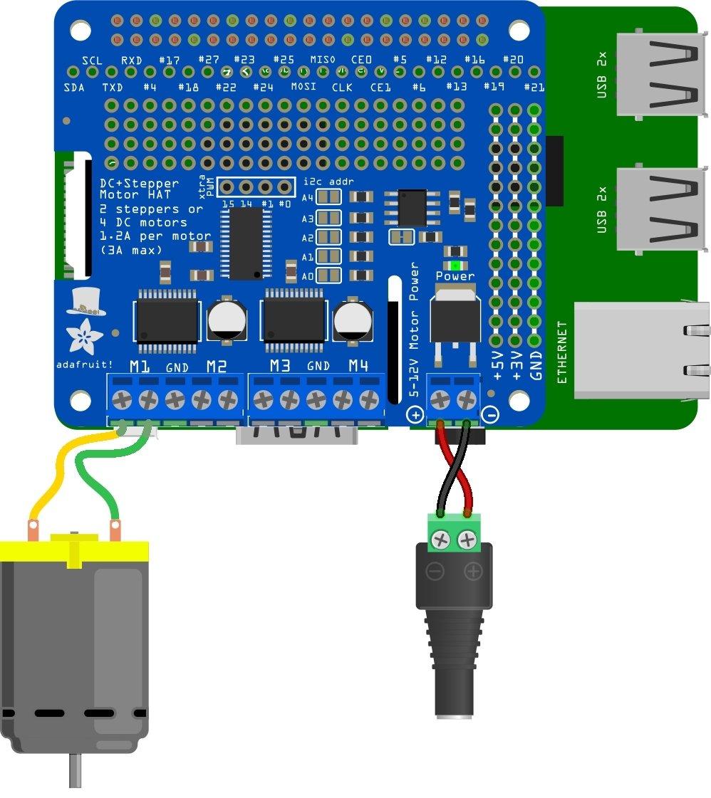

Step 3: Connect the SSR to the Raspberry Pi Hat
Chose one of the channels in the Adafruit hat and connect it to your SSR following up the picture.

You need two buck converters because your hat is 12V while your raspberry pi is 5V, so you power them separately.
