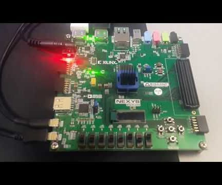

As the computing platform the ZYBO evaluation board, containing a heterogeneous Zynq SoC device was used.

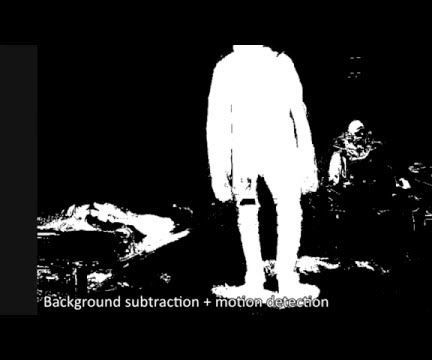

Step 1: Tracking Algorithm
Tracking differs from other image processing algorithms in that it is necessary to use information from more than one video frame. This is particularly evident, when there are few objects similar to tracked one in frame. Then information about objects' locations in the past is required to distinguish them.
Significant problems with object tracking may be caused by changed orientation of target and its high speed in comparison to frames frequency. In case of moving camera, errors may be caused additionally by image blur.

Mentioned algorithms were tested in MATLAB in order to evaluate their effectiveness for recorded test sequences. Chosen algorithms (tracking by detection, mean-shift) were implemented in programmable logic. Output (object position) was sent with use of AXI interface to processor system.

ZYBO is connected with camera, servo controller and position sensors. To change cameras position a command has to be sent to controller, which sends pulses of appropriate duration to servos. Controller is also capable of providing sufficient current for motors. In order to realize communication between controller and ZYBO, a logic level converter had to be used.
