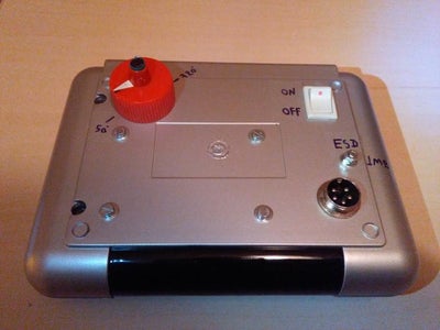

First i opened the old modem removed everything from inside. (pliers).
Then i planned the position of each part, the pcb,
the connector, the potentiometer, and the on off switch.
I drilled the necessary holes.
I enlarged or modified the holes with files.
With files you can carefully erase all the letters and logos.

As you can see i used the enclosure upside down
since it was more planar on the down side.

I needed a knob for the potentiometer. A big one.
And then i came across this empty glue bottle!
I used the cap to make the potentiometer knob.
If the diameter of the pot shaft is small you can use heatshrink tube to make it bigger.
I finally used a pin to prevent self rotation as shown in the photo.
(i drilled the appropriate 0.8mm hole first).

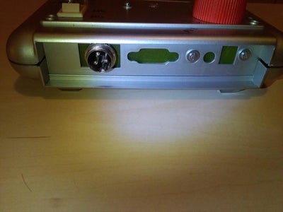

Step 3: Finally I Added Rubber Feet.
The port you see is for 20V dc power.
The station is upside down in this photo to show the rubber feet.
I covered the modem unnecessary holes with plastic sheet from an old notepad.
