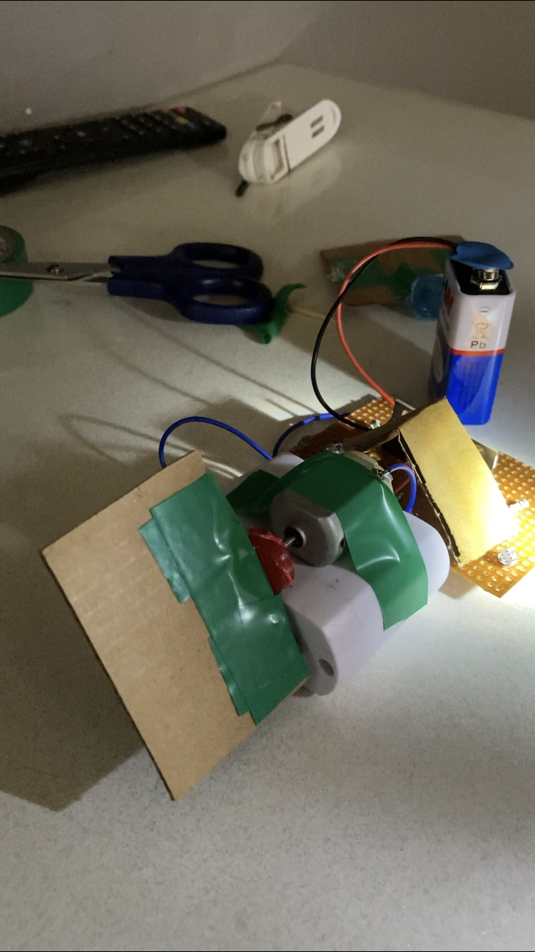

Step 3: Hardware
The entire circuit was made with Perfboard, with the LDRs connected to the sides and the voltage divider in the center.
In between the voltage divider and the LDR - resistance connection, the TDA2030 op-amps were placed. The op-amp is a 14W audio amplifier which is able to drive my motor without the need of an H-bridge. It has 5 terminals, 1 - non-inverting, 2 - inverting, 3 - GND, 4 - Out, 5 - +Vcc
The LDR-resistance is connected to pin 1 of both the op-amps, forming a node, and the voltage divider is connected to pin 2 of the op-amps.
The motor is connected to pin 4 of both the op-amps.
The motor shaft was connected to a cardboard which is imitating as our panel.
The original plan for the tracker was to mount the LDR on the panel (cardboard) and flash the light on it to showcase the output, but the motor was not able to rotate the mechanism, so I mounted the LDRs in the Perfboard itself.
In the actual circuit, you must mount the LDR on the panel itself. Otherwise your motor will keep on rotating and won't stop.
I have used a 5V DC motor since gear motors were expensive for me. So in order to not let the motor rotate continuously, I placed a limiter (it was the plug-in terminals of a USB charging brick) and stuck the motor with insulation tape. That way, the motor movement is limited.
A cardboard was placed between the LDRs to act as a shade.
Step 4: Final Working
The above two videos will help you understand how this circuit exactly works as a tracker.
1)The first video showcases the working of the tracker
2)The second video showcases how the tracker resets the panel when dawn hits the tracker.
The DC motor rotates quickly in this video. This is because it is a DC motor, not a gear motor.
The connection of LDR should be like I mentioned above, otherwise the motor will keep on rotating and tracking action will not take place.
A torch was used to imitate the sun and with the help of cardboard shades, the shadows will make the other LDR dark.
