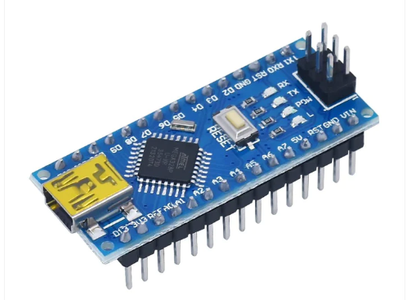

for the Arduino Nano version:
  1. Arduino Nano or Arduino Pro Micro

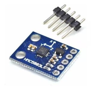

  2. QMC5883L Magnetometer board

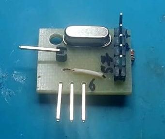

for the ATtiny 85 version (which requires a custom PCB):
  1. ATtiny85 (SOP8)
  2. Half height 7.3728MHz crystal
  3. (2) 22pF 0805 capacitors
  4. (3) 10K 0805 resistors
  5. (1) 100nF capacitor
  6. (1) FR4 single sided PCB (and etching materials)
  7. (5) Dupont PCB male pins (may come included with the QMC5883)
  8. (4) 90° Dupont PCB male pins
  9. (1) short piece of cable
  10. (1) Futaba male to male cable

Warning: the QMC5883L chip is 3.6V max, so, if you build this project use a sensor like the one in the photos (which has a voltage regulator and works in 5V)
Step 1: Arduino Nano Code
Arduino Nano Connections:
Nano QMC5883L
GND -> GND
5V -> VCC
A4 -> SDA
A5 -> SCL
Nano S.PORT
GND -> GND
VIN -> VCC
D2 -> Signal
The code will work as it is with the unmodified QMC library if you use an Arduino Nano, but you will need copy the attached trimmed version in the sketch folder if you use the ATtiny85 version (do NOT install the QMC library if using an ATtiny85).
If you would like to improve precision, I suggest you analyze the full QMC library, do a calibration and save the obtained data hardcoded in the source code as there is no room for the calibration routine in the ATtiny. You should also add the declination for your location to the code.
CODE: see attached .ino file.

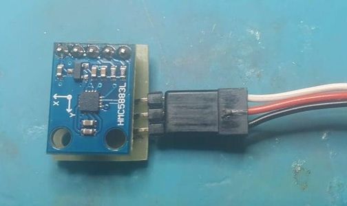

Step 2: ATTiny Version
These photos contain the Schematic, PCB (top view), component mount (bottom view), and prototype for the ATtiny85 version.
Please notice there's no room in the ATtiny85 for a bootloader. The lonely pin in the center is connected to the ATtiny's /RST pin and used for the Arduino UNO as a programmer.
ATtiny connections:
ATtiny85QMC5883L
GND -> GND
5V -> VCC
PB0 (pin 5) -> SDA
PB2 (pin 7) -> SCL
ATtiny85S.PORT
GND -> GND
5V -> VCC
PB1 (pin 6) -> Signal
