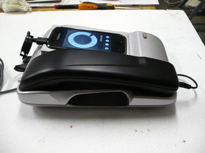

Introduction: An Office Phone From Your Cell Phone.
With this guide you can transform an old telephone in a friendly device that uses your mobile phone.

Well, the phone is finished, you just insert it into your cell.
Step 24:
Now think: beautiful and functional but the handsets where is? The handset has been done previously with this guide. If you want a touch of class you can install this free application. In the pictures you can see to follow even the use of cables for charging the handset and mobile phones.
Good luck and have fun.
