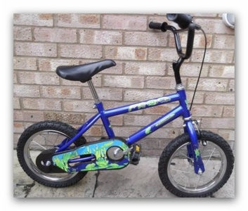

  1. The wheels from two frog bikes (one my sons' the other £2.00 from a car boot sale)

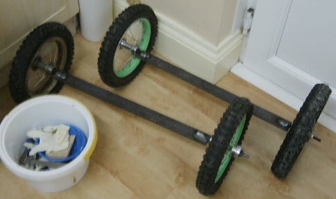

Star by stripping the wheels from both bikes and remove the axles (make sure you don't lose the bearings.). Also remove any cogs from the rear wheels they will not be needed for this project.

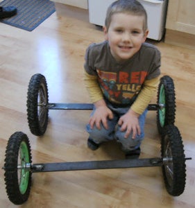

You will be left with 4 axles clean them up and pair them - this is important as you want to have similar wheels at the front and rear. If you look at the axles and the nuts you will note that two will be thinner than the others, these are from the front wheels of the bike - I used those for the front wheels of the cart.
The axles of the cart are made by welding the bike axles to a piece of steel - now I can not weld so for this part I took the studs to a local garage who did the welding then charged me and gave the money I handed over straight to my son (nice people).
Take a look at the pictures you will see the completed axles once I had reassembled the wheels.

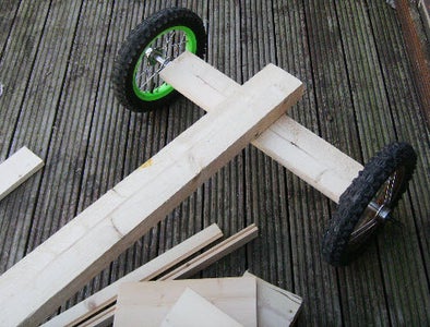

Take one of the 55 cm beams and make a notch in it at the half way point that is large enough to sit the long bean in, then on the other side along its length make a recess to take the steel on the axle, st the ends you will need to remove a little more material as the welded part of the bike studs will be facing up into the beam. (repeat this for the other 55 cm beam which will be the front axle).
Clamp the axle with the rear bike wheels to the first 55 cm beam and then to clamp the 125 cm beam into its notch - allow it to over hang at the rear by approximately 15 cm then drill a series of holes along its length to tak the coach bolts used to hold it together.

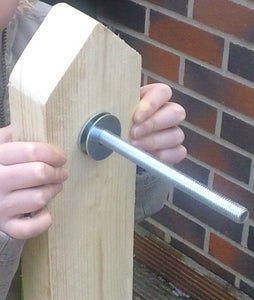

Repeat this clamping and drilling process for the front axle then use a long coach bolt and two large washers to attach the front axle - for all bolts I used locking nuts , but also applied thread lock as well.
The rear needs 5 holes the front only three. on the front put the other two holes close to, but missing the weld at the wheels the use the eye bolts with large washers front and rear - this is where you will be attaching the rope

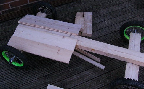

Cut some scrap T&G to pack up the space from the rear axle to the top of the long beam on both sides. and cut some extra as well
The extra is used to form a cross beam support for the front of the seat (see the last picture) basically use the scrap spacers and a length of the T&G to sandwich it over the 125 cm beam. I also used the added 4 cm bean as a strengthener under the cart.
When you are ready clamp it all together and start putting the bolts in (use your children as counter weights if needed.
